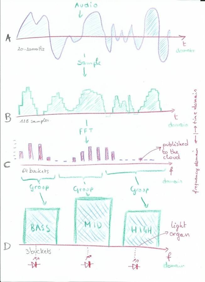

Today I'm taking that great leap to the cloud. The Perpetuum Ebner goes online and publishes what's happening.
What is the Turntable Publishing?
I have 3 interesting sets of data available in my design.
  • The raw sampled data, 128 8-bit samples covering the audio frequency range (signal B).
  • That same information transposed to the frequency domain: 64 buckets, each representing a subset of that frequency spectrum (signal C).
  • Those 64 buckets grouped into a Bass, Mid and High range (signal D). That's the info that drives the LEDs of the light organ.
I could publish any of the three. To make the decision, I thought about what the consumer is going to do with the data.
My plan is to make a remote light organ, and a WiFi spectrum display.
For the light organ, signal D would be OK. In that case I could even simplify the signal and stick with 2 bits to hold the on-off information for the 3 LEDs.
But if I want to keep the options open for a wireless spectrum display, I'll need signal C. That signal is also usable as source for the remote light organ.
The easiest decision would be to send signal B, the full samples. But engineering is about making decisions and trade-offs.
I'm not painting myself in a corner here. In the future I can always switch to signal B if needed. I could publish them in parallel until all subscribers are converted, and then switch of signal C.

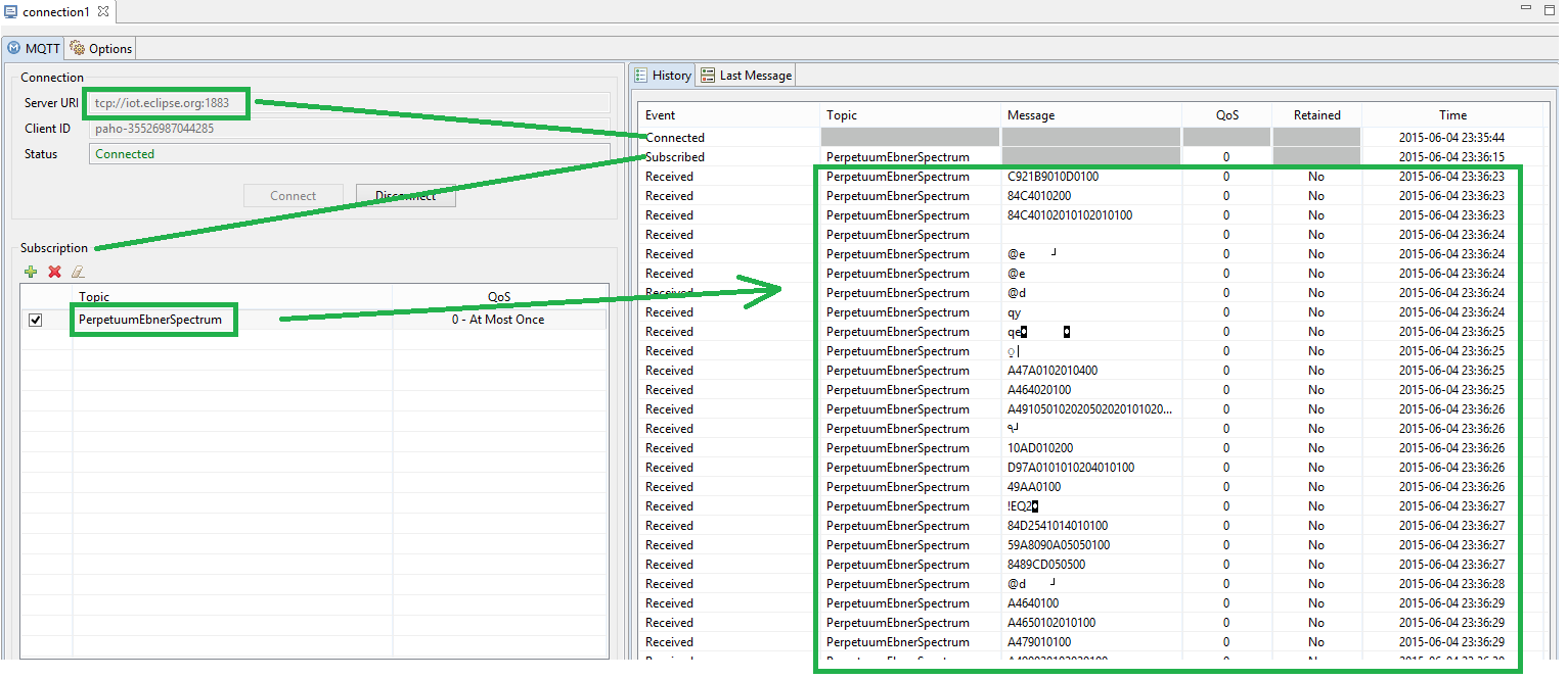

Firmware with MQTT Publishing
The firmware builds upon the previous versions. The only addition is that I now publish the 64 buckets every 20th sample.
This is again a trade-off. My design can go faster, but I figure that eclipse.org doesn't like to be hammered by my data every few milliseconds.
So I settled for the lowest speed that would still give an interesting and lively visual result.
I subscribed to my data with eclipse PaHo client. The screen capture above shows the received data. It's normal that the characters don't display right, because the payload isn't text. It's 64 8-bit nuggets of info.
And here's the latest firmware:
