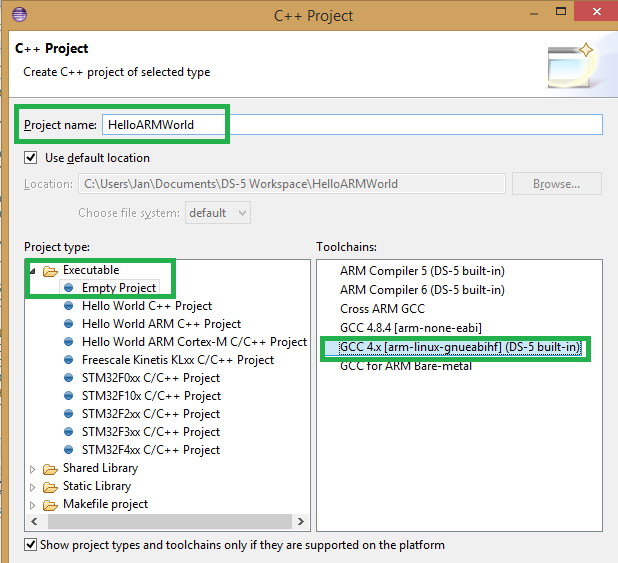

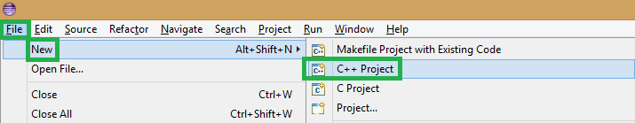

Step 1: Start Eclipse for DS-5 and create a new C++ Project
Step 2: name the project, type = Executable : Empty Project, Toolchains: GCC 4.x built-in (or another one, I wasn't adventurous enough yet to try a different one then that of the how-to guide image )
Next and Finish

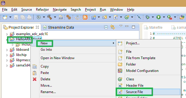

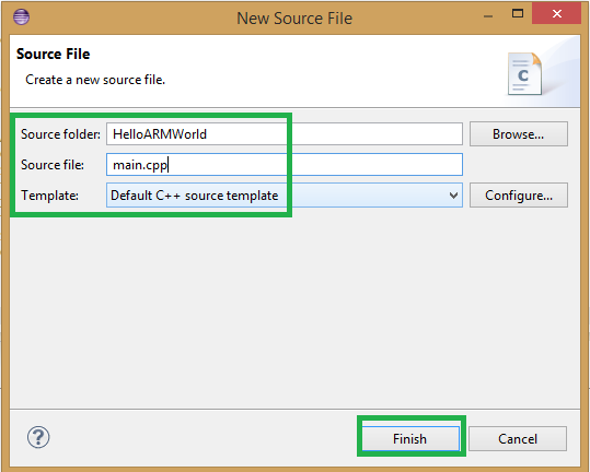

Step 3: create the main.cpp file by right clicking on the project and adding a new C++ source file

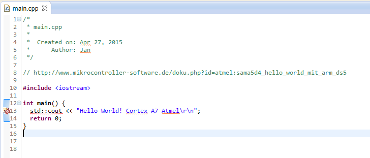

Step 4: Enter the source lines. I stayed faithful to the example and kept the word A7 in there.
#include <iostream>
int main() {
  std::cout << "Hello World! Cortex A7 Atmel\r\n";
  return 0;

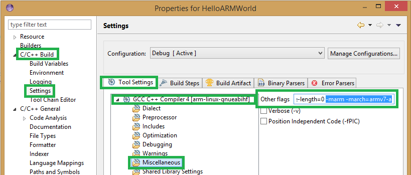

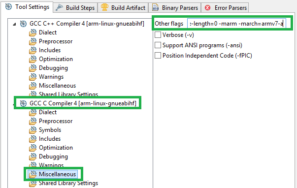

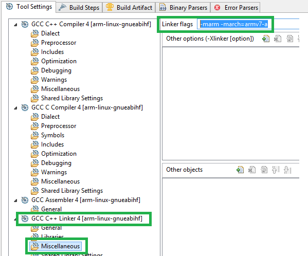

Step 5: inform the toolchain about the target platform. You do that by setting additional flags on the command lines.
The following flag needs to be added (see the original how-to to check why ARM5 needs v7):
-marm -march=armv7-a
a:
b:
c:

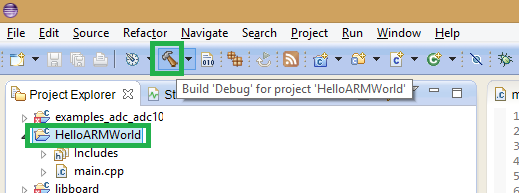

Step 6: build the program
Step 7: review the console output:
12:21:50 **** Build of configuration Debug for project HelloARMWorld ****
make all
'Building file: ../main.cpp'
'Invoking: GCC C++ Compiler 4 [arm-linux-gnueabihf]'
arm-linux-gnueabihf-g++ -O0 -g3 -Wall -c -fmessage-length=0 -marm -march=armv7-a -MMD -MP -MF"main.d" -MT"main.d" -o "main.o" "../main.cpp"
'Finished building: ../main.cpp'
'Building target: HelloARMWorld'
'Invoking: GCC C++ Linker 4 [arm-linux-gnueabihf]'
arm-linux-gnueabihf-g++ -marm -march=armv7-a -o "HelloARMWorld"  ./main.o
'Finished building target: HelloARMWorld'
12:21:54 Build Finished (took 3s.862ms)

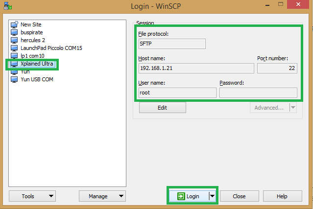

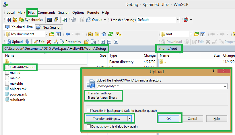

Step 8: load the program and set it as executable
a: load the program, in binary mode, with your favorite SCP tool (I use WinSCP)
b: start your favorite terminal (I use PuTTY) and set the executable flag and verify that all is ok
chmod +x HelloARMWorld
ls -l

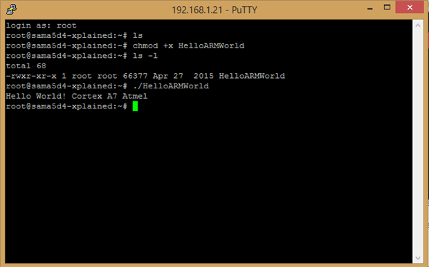

Step 9: execute the program, sit back and enjoy your success
./HelloARMWorld
