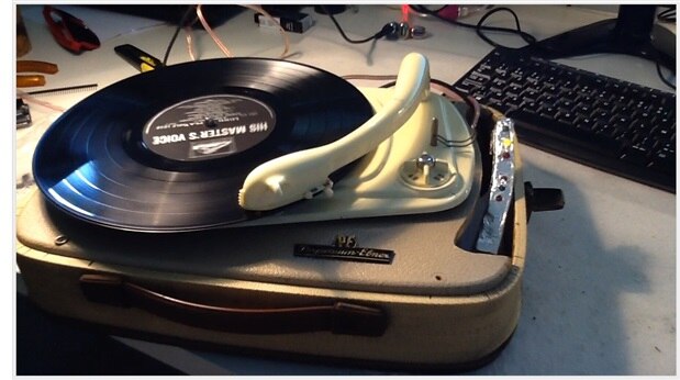

In this episode, I'm combining the light organ and the servo control into one Arduino UNO..
It's also the first provisional attempt of mounting into the base of the turntable.
How the Light Organ and the Servo Lift Work Together
I want the light organ and the lift to just work together, without me having to worry about them.
In previous posts I have introduced the autonomous light organ and the autonomous lift.
They are now combined on a single Arduino, but still have a life of their own.
As soon as the music plays, the light organ will do its work and starts flashing its LEDs.
At the same time, it will tell the servo to move up and stay up for a while (its lifespan: 150 while loops).
Each time a LED is active, it renews the lifespan. But when there's no LED on, one point is taken from the lifespan.
If all the lifepoints are taken, the servo retreats and moves the LEDS back inside the case.
A video says more than 1000 words:
The code is simple. Search for the word decay to find out what's happening.
