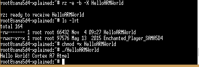

On the linux prompt, log on as root.
Start the XMODEM listener
Prepare your linux session for file receiving by entering the rz command:
rz -e -b -X HelloARMWorld
rz is the file receive command.
-e takes care that all special commands are properly escaped
-b does a like for like (binary) transfer
-X selects the XMODEM protocol

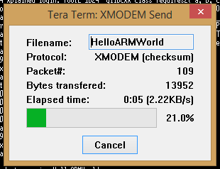

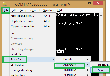

Send the file
On the Tera Term menu, select File -> Transfer -> XMODEM -> Send...
A dialog pops up to select the source file. Once you selected the file, a progress bar appears:

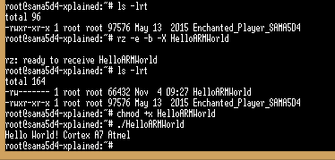

When that transfer is finished, the file is available on linux.
The only thing we have to do is make it executable:
chmod +x HelloARMWorld
and run it:
./HelloARMWorld
Done !
