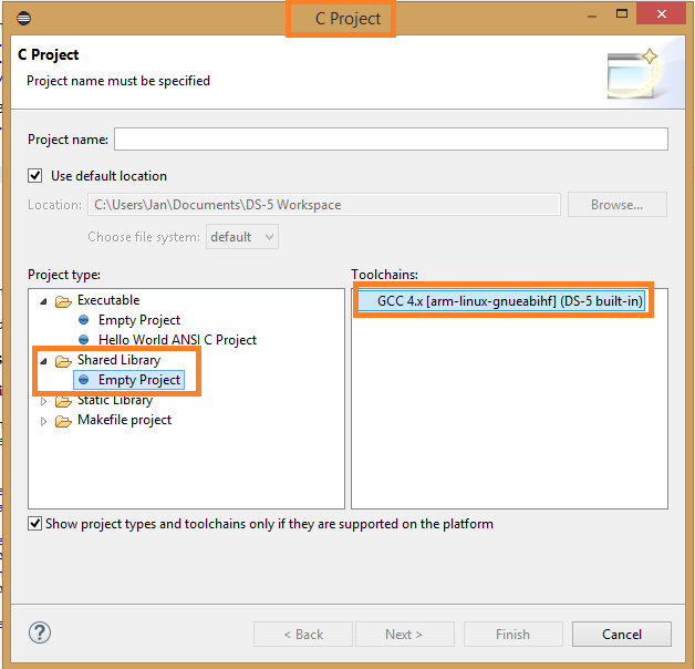

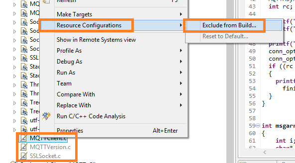

Then I created a new Shared Library project in DS-5. I've used the makefile source as guideline to check what files to compile and what command line options to pass to the toolchain.
I carefully studied the makefile to understand what files to include/exclude from build, and what settings to port from make to DS-5.
I'm building the async lib version without SSL, so I took over the settings from that lib's make commands.
I excluded the files listed in this variable from compilation, just like in the make script.
SOURCE_FILES_A = $(filter-out $(srcdir)/MQTTClient.c $(srcdir)/MQTTVersion.c $(srcdir)/SSLSocket.c, $(SOURCE_FILES))

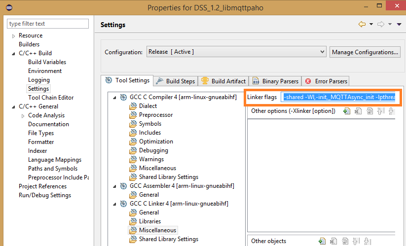

MQTTASYNC_INIT = MQTTAsync_init
and incorporated it in the linker flags:
Then I built the project. That gave me a compiled .so library.

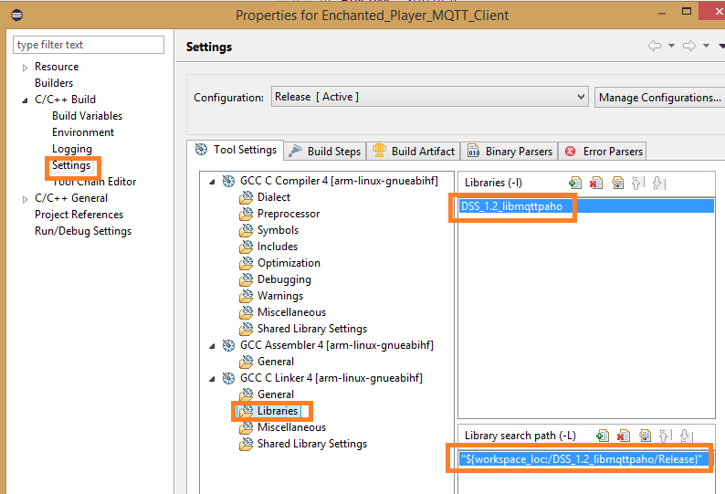

I took care that the async shared library was available to the linker:

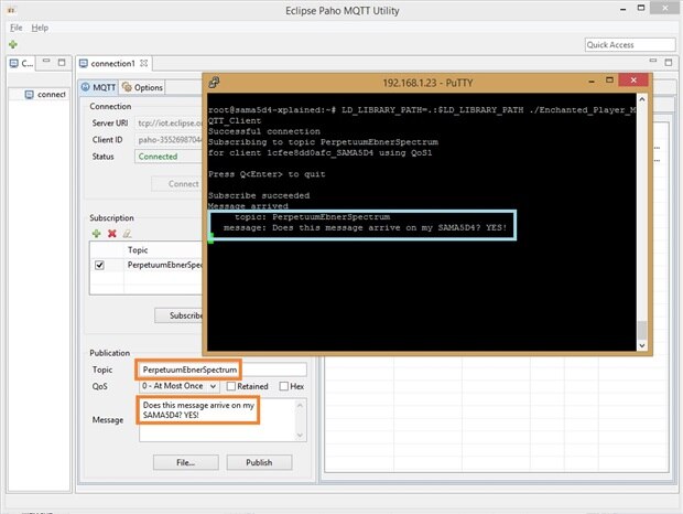

$ LD_LIBRARY_PATH=.:$LD_LIBRARY_PATH ./Enchanted_Player_MQTT_Client

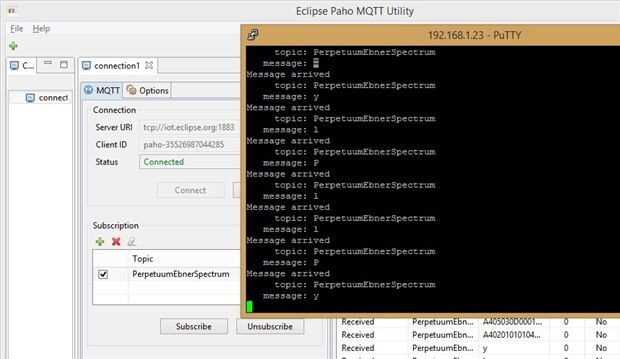

Nothing more to say. Success. It just worked. My audio spectrum, sampled by the Yún inside my turntable, arrives nicely on the SAMA5D4.
