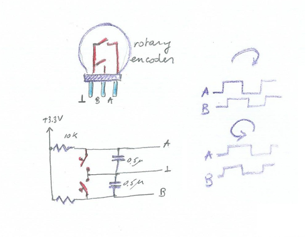

Check Rotary Encoders - Part 1: Electronics for the details of the encoder.
image: the rotary encoder (scroll wheel) hardware. With pull-ups and debouncing capacitors

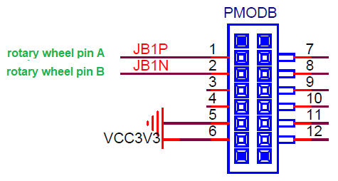

In this design, I'm connecting it to PMOD connector B.
Encoder pin A is connected to PMODB 1P, pin B to PMODB 1N.
The ground and 3.3V for the encoder are also connected to that PMODB connector.
image: physical connection between PMODB and the two scroll wheel connection
On the Zynq, the 2 PMODB pins (and the wheel pins) are connected to package pins W14 and Y14.
That info can be found in the package support file for the Zynq Z2 kit: PYNQ-Z2 v1.0.xdc.
image: the I/O view is used to set pin constraints and assign PMODB connected package pins to the two FPGA inputs.

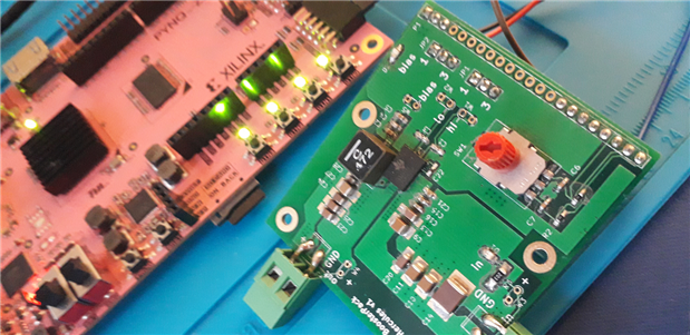

image: hardware used in this example is the scroll wheel module of Hercules LaunchPad and GaN FETs - Part 3b: BoosterPack Layout - my version

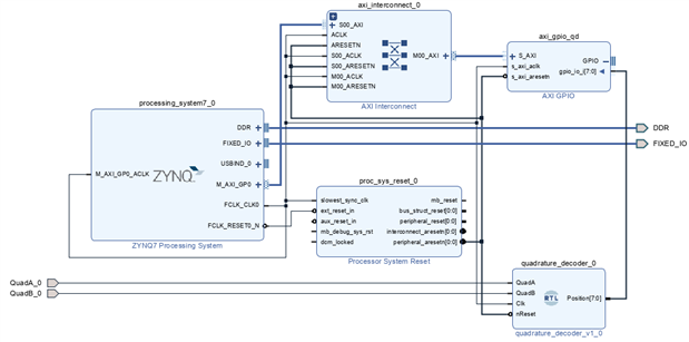

Vivado Project

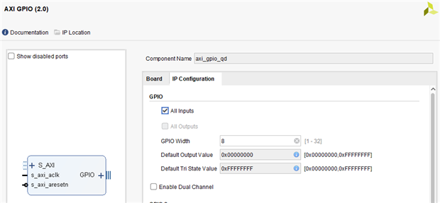

The project isn't a lot different than the previous one. The only difference is in the axi_gpio block.
This time, it's defined as an 8-bit input register.
image: the axi gpio block is set to input mode
The two pins for the rotary encoder A and B signals are made external. For the rest, this is exactly the same as in my previous posts for the PWM design.
image: the full block diagram is very similar to that of the previous pwm example
If you replicate this exercise: there is a mistake. The interconnect reset should go tho the first reset of the AXI Interconnect IP.
All other resets should connect to the peripheral reset pin.

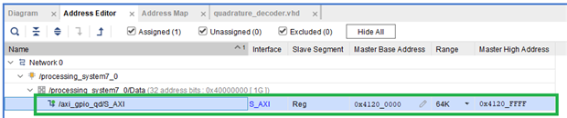

The register needs an address. I have let Vivado generate that.
In the address editor, I clicked the S_AXI entry, right-clicked, and selected Assign.
image: the register memory map auto assigned in the address editor
Then, I ran the Synthesis, and assigned the IO pins (see the Hardware section above).
Then, I generated the bitstream.

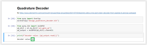

Jupyter notebook
This one is also comparable with (and derived from) beacon_dave 's PYNQ-Z2 Workshop - AXI GPIO post.
image: the Jupyter notebook in action
First, the overlay is loaded
from pynq import Overlay
ol=Overlay("design_quadrature_decoder.bit")
Then, the utility lib for AXI GPIO is loaded, and I retrieve the interface for the VHDL wrapper:
from pynq.lib import AxiGPIO
qd_dict = ol.ip_dict['axi_gpio_qd']
qd_output = AxiGPIO(qd_dict).channel1
That's it. You can now get the current value of the encoder at any time:
print(f"decoder value: {qd_output.read()}")
image: the Jupyter notebook shows the current position of the scroll wheel

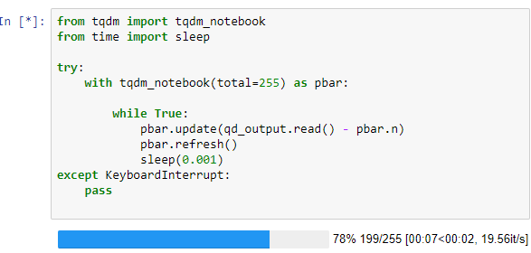

It also works together with the tqdm progress bar:
from tqdm import tqdm_notebook
from time import sleep
try:
    with tqdm_notebook(total=255) as pbar:
        while True:
            pbar.update(qd_output.read() - pbar.n)
            pbar.refresh()
            sleep(0.001)
except KeyboardInterrupt:
    pass
When you rotate the wheel, the progress bar on the Jupyter book updates.
image: infinite loop gets current scroll wheel position and updates the progress bar
Note that this progress bar only shows updates for value increments, not if you set the value lower than the previous one.

    I've updated  the attached Vivado project, with the interconnect and peripheral resets split up:
