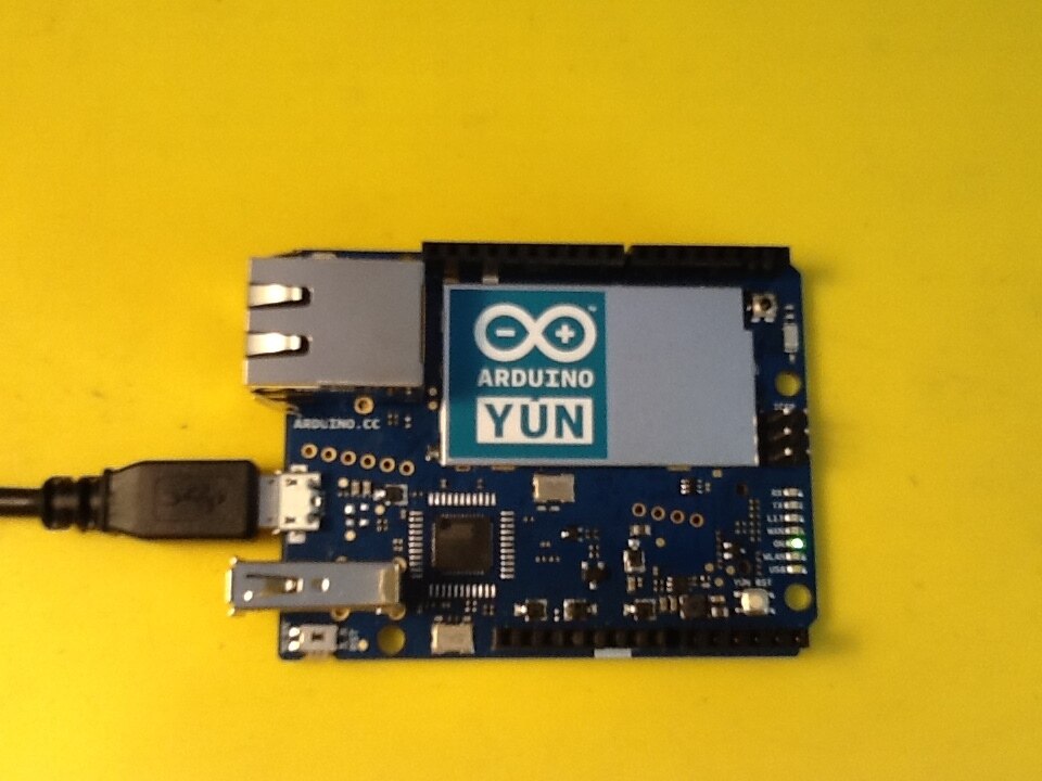

From UNO to Yún
My UNO was running the light organ and servo lift code. Today's exercise is taking care that that info is ported to the Yún.
And to check that there's enough space left to talk to the cloud.
That was a fairly easy task. To cut a long story short: the code just ported straight away.

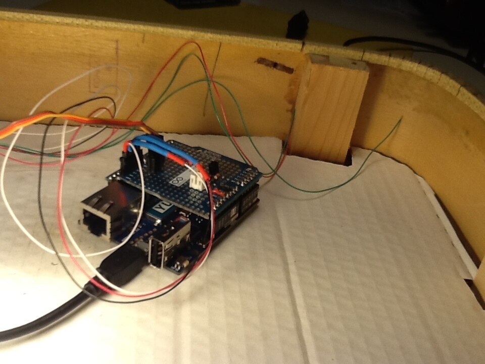

The second thing to consider when porting, is the form factor of the Yún. More specific: the USB and ethernet connectors.
The protoboard that's part of the enchanted objects package doesn't fit out of the box.
This is what I have done to it:
I used my fake dremel and sliced the board in half. That way it fits on the Yún.

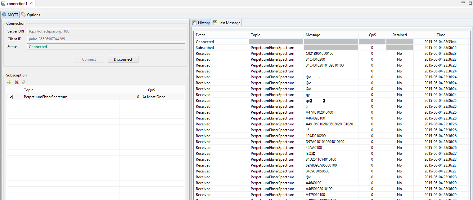

    Jan Cumps over 11 years ago +2
    My turntable is sending spectrum data to the cloud: What you see is 64 buckets across the audio spectrum, quantified for the amount of signal in each bucket. I can now do 4 things (and more ): - build…
    I can now do 4 things (and more image ):
    - build a remote light organ that subscribes to this message and flashes its lights
    - build a wireless spectrum analyzer (I could do this with a 16 character LCD, and group some of the channels together)
    - ask others to subscribe to my broadcast and build a thing that reacts on my audio
    - build a software light organ or spectrum analyzer that displays info on the signal.
