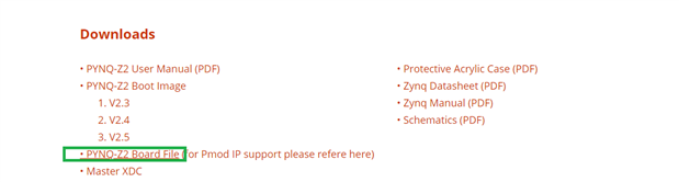

Get the board file
The files listed on pync.io are not available. I found them here.

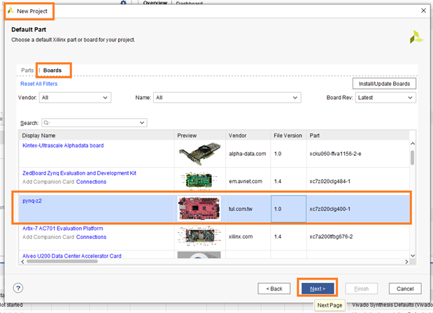

Then there are two options.
  • (deprecated) Directly put the files in the Vivado boards folder: <Xilinx installation directory>\Vivado\<version>\data\boards\board_files.
  • Or (preferred)  put them at a location you decide, and add a line to the Vivado init file, %APPDATA%/Xilinx/Vivado/init.tcl (create it if it does not exist)
    set_param board.repoPaths [list "D:/Xilinx/pynq-z2/A.0"]
I used the 2nd option. You have to restart the editor.

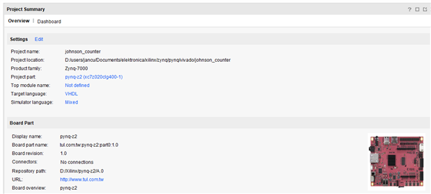

The result is that you can now create projects that have the right FPGA info for the Pynq-Z2:
