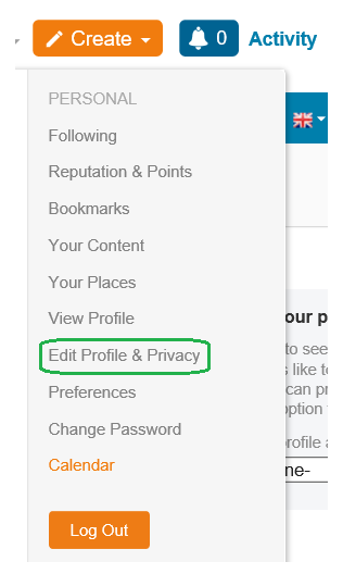

  • beacon_dave
    beacon_dave over 5 years ago in reply to Jan Cumps
    Maybe the Okay to contact?: setting:
    Jan Cumps over 5 years ago in reply to kk10
    I don't know. Normally when I connect to someone, I can send PMs.
  • kk10
    kk10 over 5 years ago in reply to Jan Cumps
    Kindly let me know how to enable that. I searched in the profile section but I was not able to locate
    Jan Cumps over 5 years ago in reply to Jan Cumps
    We are now contacts but I can't send you messages. Have you disabled PMs in your profile?
    I invited you as a contact. If you approve, I can send  my coordinates via a PM.
    Did you try to follow the steps after you installed 2020.1?
    If yes, can you please post feedback to the 6 questions I asked above, so that I can join our session prepared?
