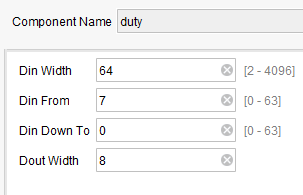

The interface will give duty cycle (8 bits) and dead time (4 bits).
I'll use 2 slice modules to cut these 2 values out of the 64 bit wide GPIO output bus.
image: interconnections. in this picture, the ARM part and the slices that provide duty cycle and dead time are highlighted.
The table below shows how the 64 bit port is "sliced" into different sections:
duty cycle dead time
image image
image: the slices that cut the 8 bit duty cycle and 4 bit dead time out of the ARM 64 bit GPIO output bus.
