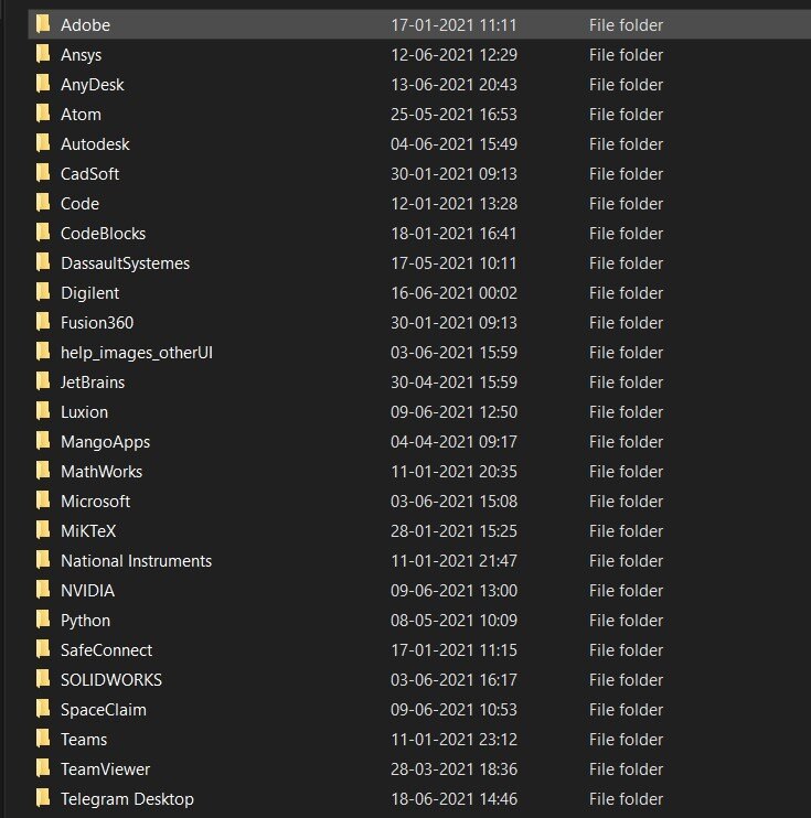

    kk10  wrote:
    I found the directory. Thank you. I have copied the extracted file into the first link which you specified. Yet when i open Vivado that board isn't visible. Kindly help me with this
    add a line to the Vivado init file called init.tcl, that is either already located in  %APPDATA%/Xilinx/Vivado, or does not exist. In the case that it does not exist create a file called init.tcl there.

  • kk10
    kk10 over 4 years ago in reply to Jan Cumps
    I have created a text file. Is that sufficient?
    Jan Cumps over 4 years ago in reply to kk10
    If the instructions above do not work for you, please contact Xilinx.
    I got the instructions from them. I followed them step by step, and it worked.
    If you also did the same, literally followed each and every step,  and it does not work, Xilinx support should be your next step.
    Alternatively you could:
    show us where your %APPDATA% directory is. (feedback)
    show us a directory listing of that directory. (feedback)
    show us the exact content of the init.tcl file in that directory (feedback)
    show us where you extracted the board info archive. (feedback)
    show us a directory listing of that directory (feedback)
    stop Vivado if it is running
    start Vivado
    show us what you see/don't see when you create a new project. (feedback)
    3rd alternative: do not follow my instructions but use the original ones: https://www.xilinx.com/support/answers/72033.html
  • kk10
    C:\Users\Lenovo\AppData\Roaming-APPDATA directory
    Use forward slashes in the text file, as per instructions.
    You use \  It should be /
    Also, you do not have part of the start of the line.
    Yours starts with ram. The instructions say to start with set_param.
    Also, you do not have the full path. The files are in pynq-z2/A.0 not in pynq-z2.
    My general advise is to stick to the instructions. It will help you with every next step on your path to master the Zynq.
