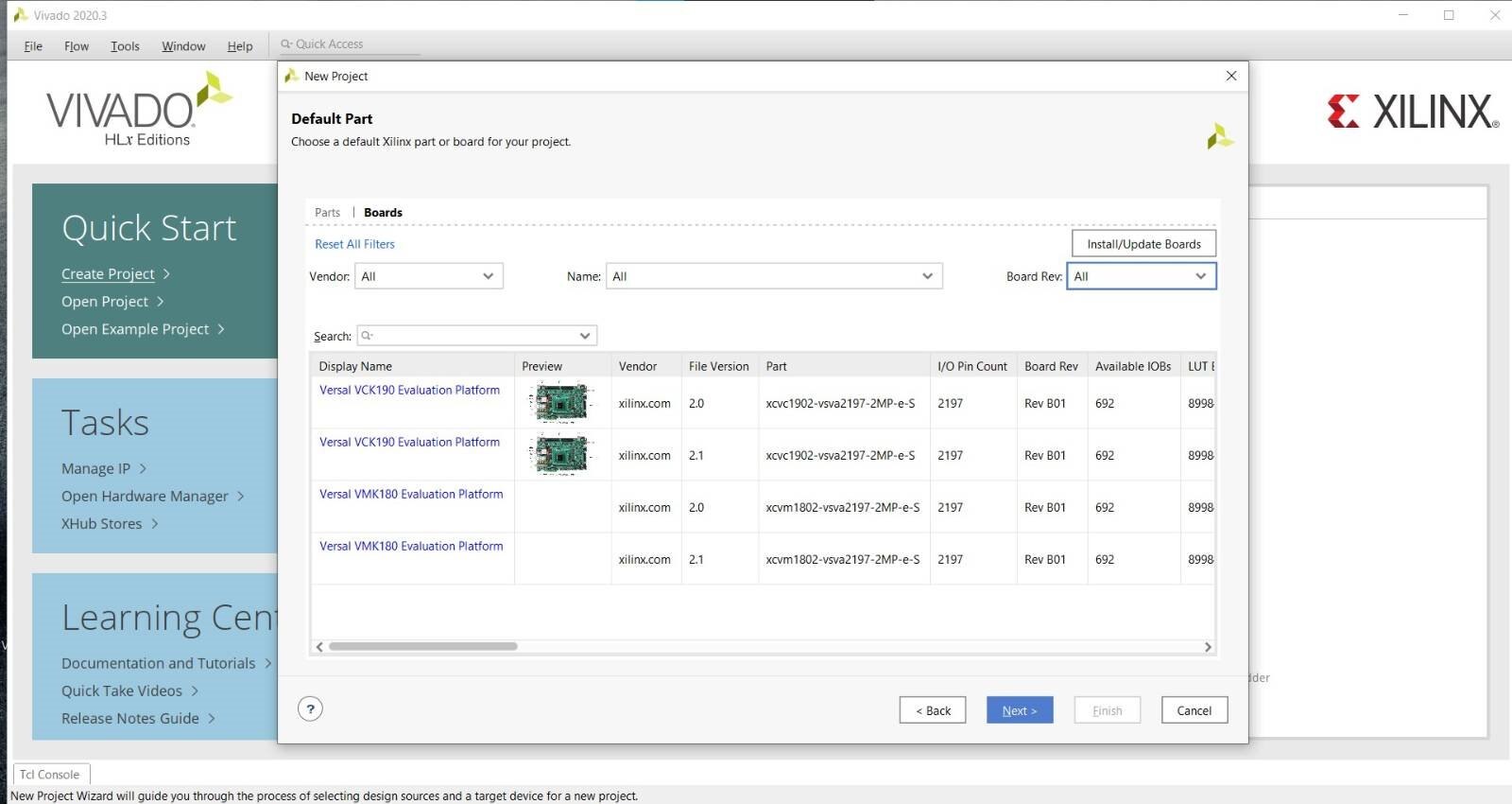

In the Vivado project creation wizard, there is a possibility to prime your design from a board definition.
You don't need to find out what the exact FPGA is, and what hardware is available.
There are more project preparation tools. Constraint files and TCL files that fully define the board with all possibilities enabled.

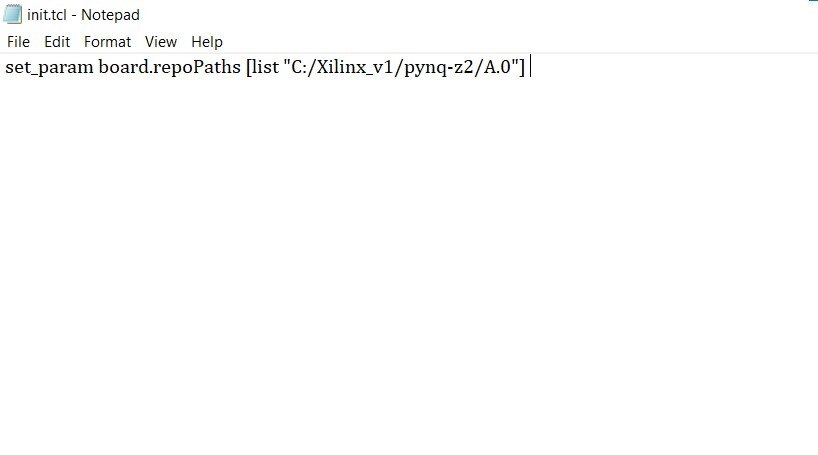

Then there are two options.
  • (deprecated) Directly put the files in the Vivado boards folder: <Xilinx installation directory>\Vivado\<version>\data\boards\board_files.
  • Or (preferred)  put them at a location you decide, and add a line to the Vivado init file, %APPDATA%/Xilinx/Vivado/init.tcl (create it if it does not exist)
    set_param board.repoPaths [list "D:/Xilinx/pynq-z2/A.0"]
I used the 2nd option. You have to restart the editor.
The result is that you can now create projects that have the right FPGA info for the Pynq-Z2:

    Hi Jan, Can I offer a suggestion? Please bold " set_param board.repoPaths [list "D:/Xilinx/pynq-z2/A.0"]" That is something that so many people miss. That is really the proper way that Xilinx suggests…

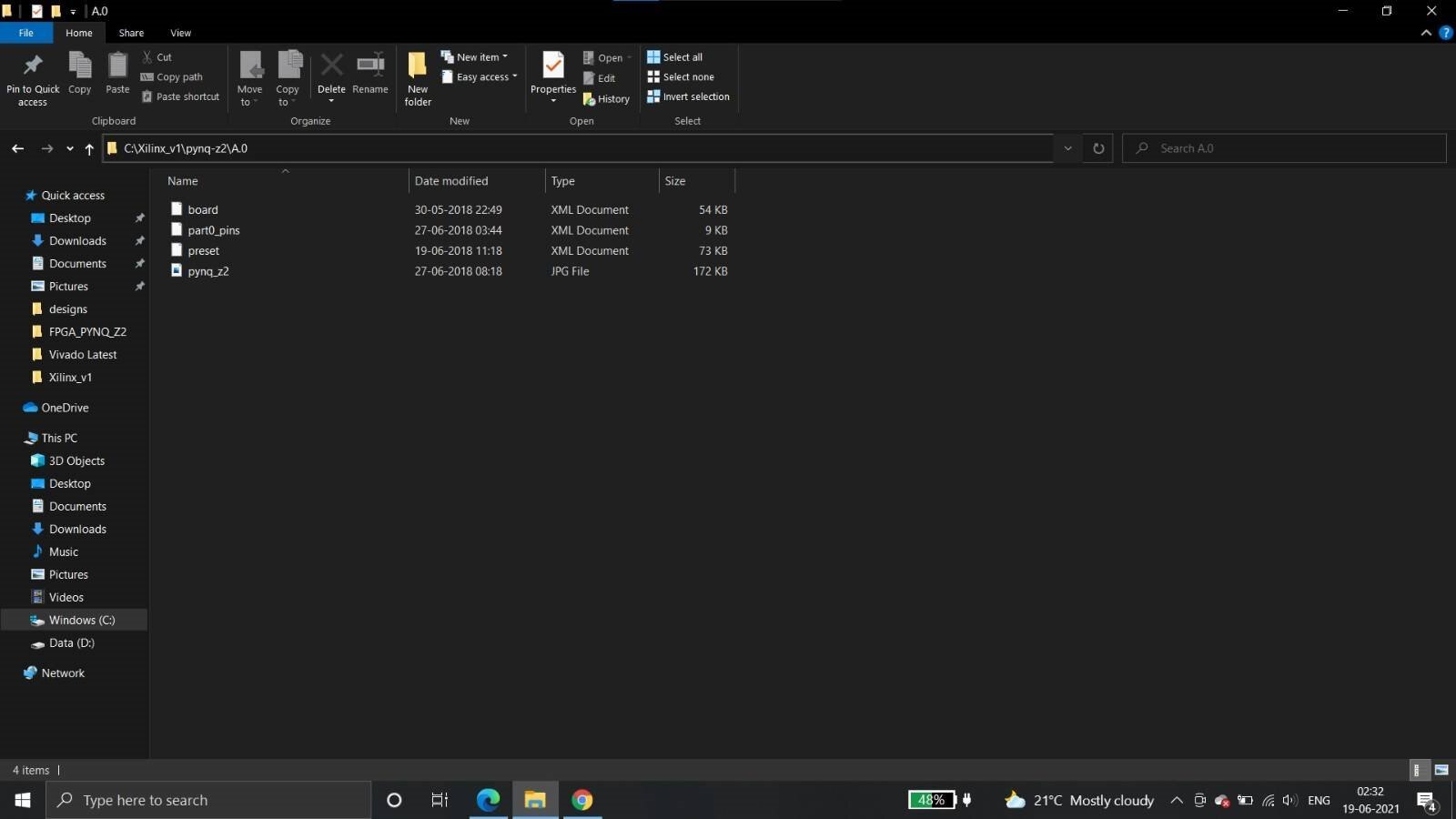

  • kk10
    kk10 over 4 years ago
    I am having trouble in installing the board in Vivado. The directory mentioned above, I have not been able to locate. Please can anyone help how to do as per the second solution mentioned above.
    Jan Cumps over 4 years ago in reply to kk10
    I mentioned 2 directories. Which one do you not find?
  • kk10
    kk10 over 4 years ago in reply to Jan Cumps
    I have changed as you suggested. Yet the board is not getting appeared in Vivado. I will try once again
    Krishna, I suggested 6 points of data to provide, so that I could check.
    You gave 4, and the 4th one was wrong.
    Please take a step back, and go methodically over each step.
    Then, provide feedback on the steps. All of them, not some of them.
    Whenever you type "the directory" or "a file", take as step back and type the actual values. It will help you.
    What files are here:
    ?image
    (I still suggest to take a step back, read the 6 questions, and feed-back on all 6 questions.)
