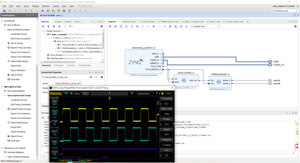

    Jan Cumps over 5 years ago in reply to narrucmot
    Testing complementary PWM signals with deadband.
    I borrowed the PWM VHDL from Lothar Miller. The clock divider is the one from the original post.
