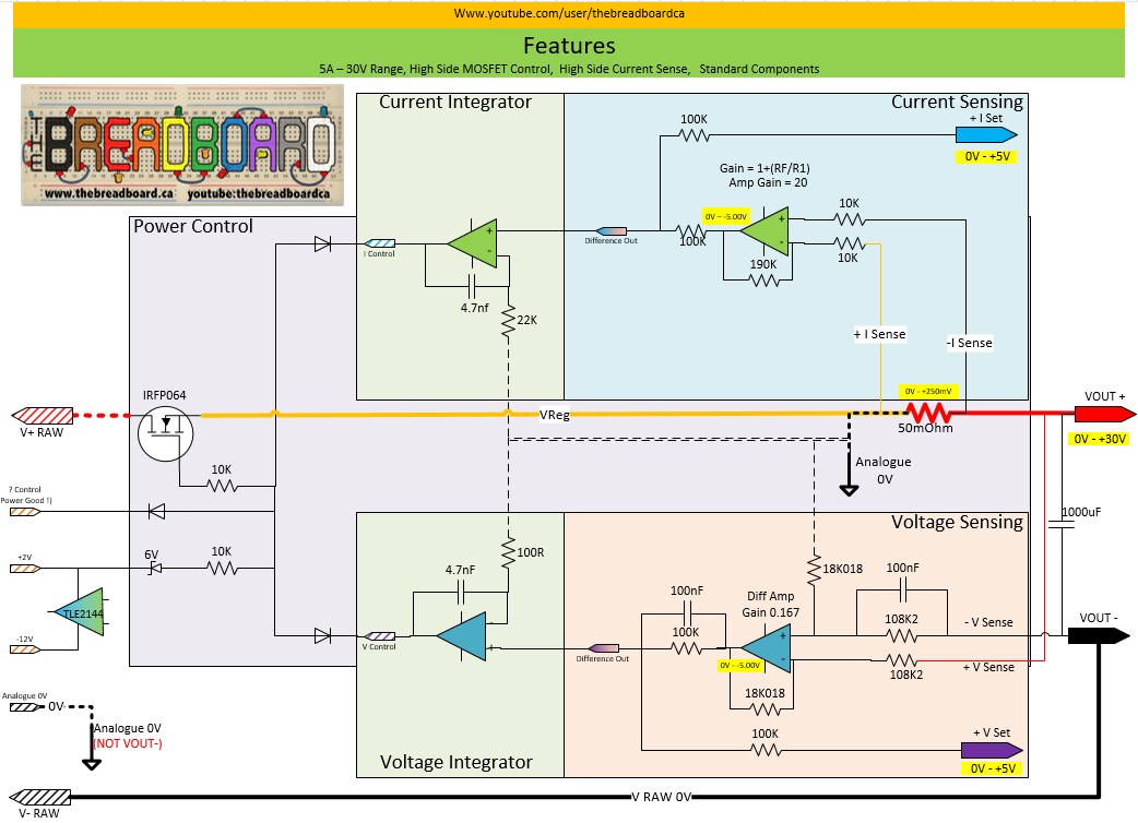

We're building a programmable DC load. The focus is on making a real world working instrument.
Hardware and firmware are open source.
  • 20 V, 6 A
  • SCPI controlled

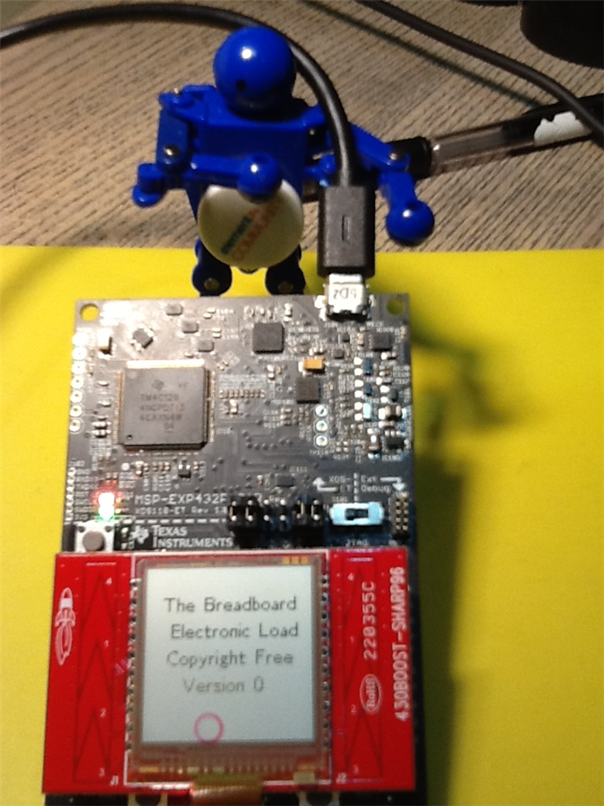

The load design is modular.
Two out of box modules:
  • MSP432 LaunchPad
  • LCD Shield (optional)
3 new designs

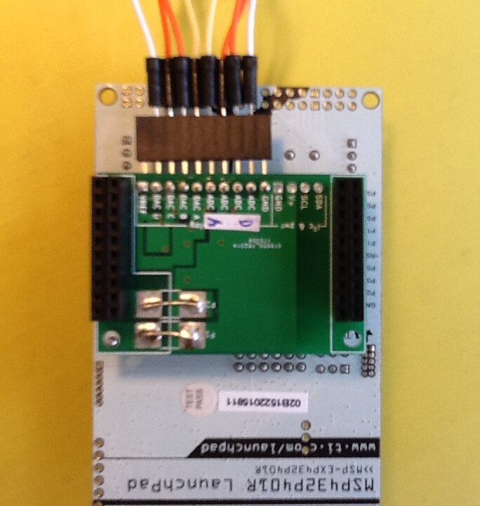

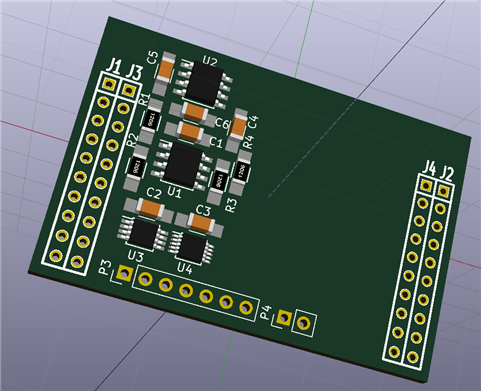

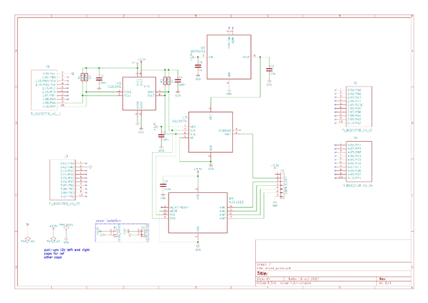

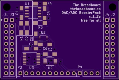

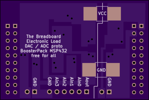

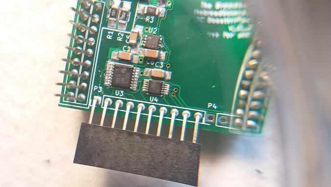

DAC-ADC BoosterPack
This module is a generic, isolated DAC / ADC boosterpack. It's the interface between the analog controller and the microcontroller.
It can also be used outside this project, for your other analog - digital conversion needs.
The board design is broken out in a separate post: Programmable Electronic Load - DAC / ADC BoosterPack.

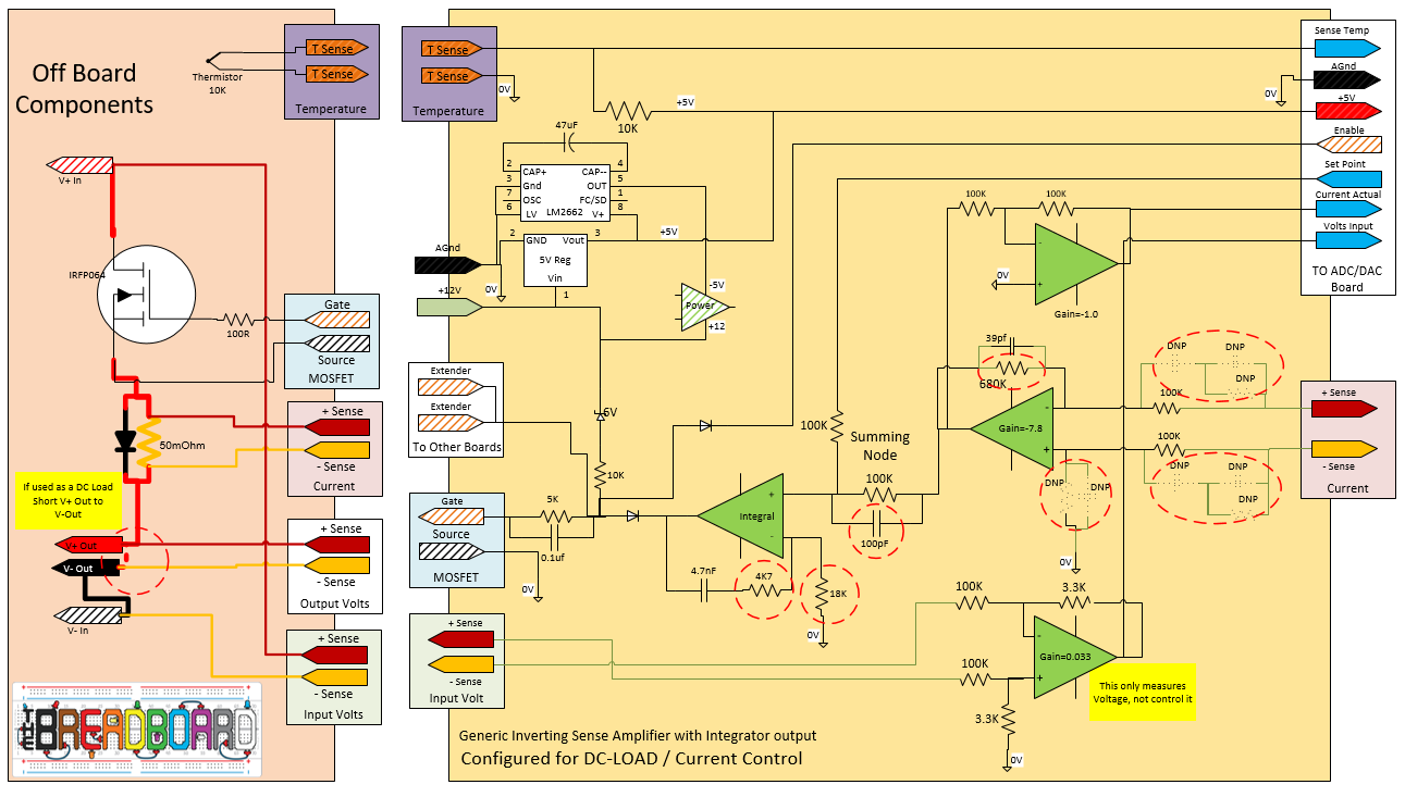

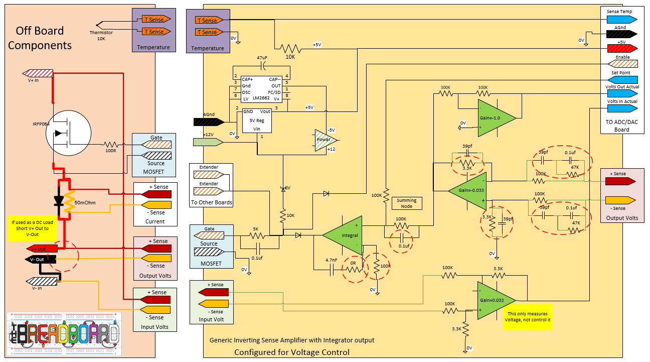

Analog Controller and Driver Board
This is the core of the analog constant current block. Here lives the circuit that will translate desired constant current into the driver signal for the power MOSFET.
It integrates the feedback coming from that power board. This is a closed analog control loop.
There are also components to provide the on-off functionality and buffers/amplifiers for the analog data-points that fly back to the ADC module.
The board, schematics and BOM are documented in Programmable Electronic Load - Analog Controller and Driver Board.

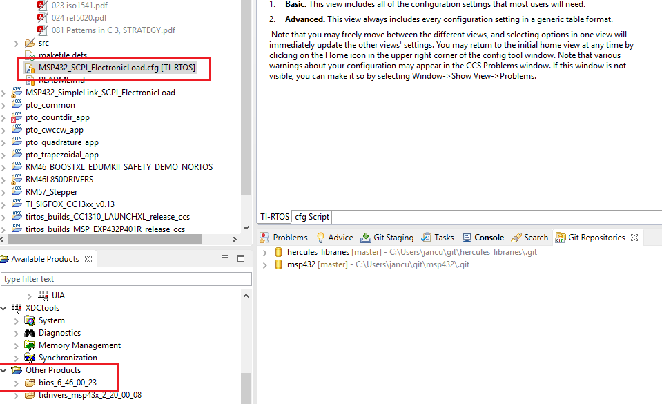

Firmware

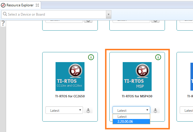

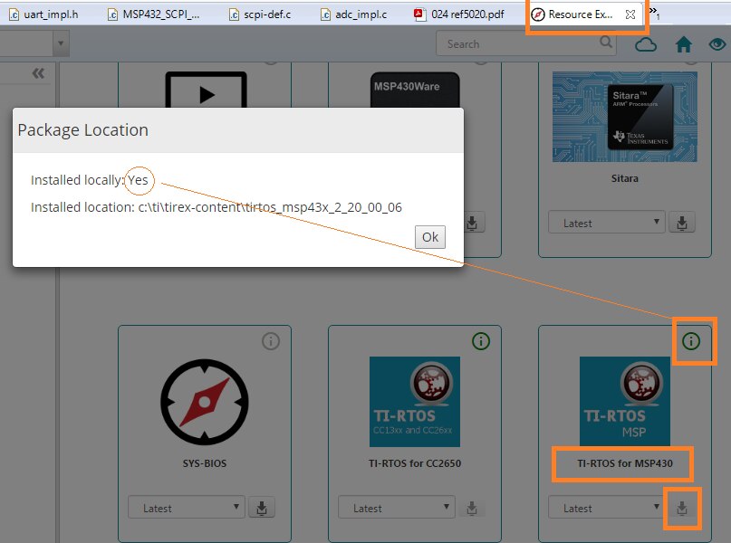

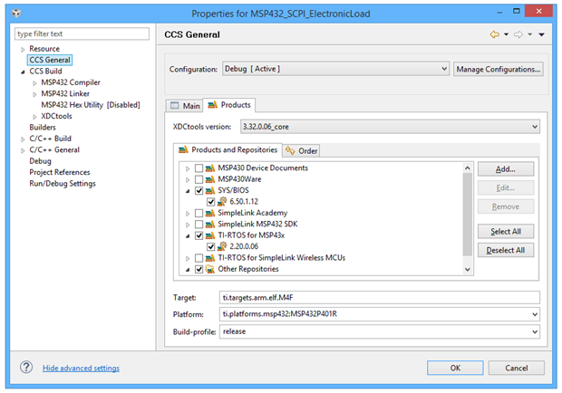

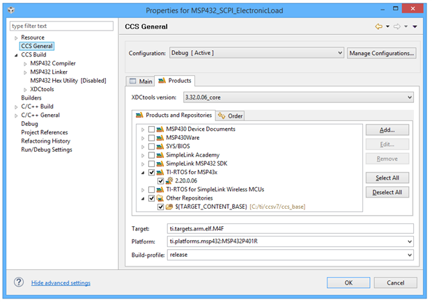

Prerequisites:
  • CCS 8 with MSP432 compiler TI v 16.12.0.STS or >
  • TI-RTOS for MSP43X, any SimpleLink version
  • MSP432 LaunchPad (not the black pre-prod because it's out of support)
The firmware is for the MSP432 microcontroller. But the harware can be driven from any controller, processor, PSoC or computer that can deliver i2c and power between 3V3 and 5V.
That includes Arduino, Raspberry Pi, BeagleBone, Warp7, IOT20xx, the ST Neo family, ... As long as they match that voltage range and have I2C master, it 'll work.
The ADC/DAC board takes care that the logic side is galvanicaly isolated from the power side (that is, if you leave the P1 and P2 jumpers open).
The only requirement is that you have a positive supply between 3V3 and 5V, a ground, and I2C signals (the board has I2C pull-ups that connect to the positive supply that you provide. If you don't want that (maybe your dev board already has 'm), leave R1 and R2 off.
ADC, DAC and Enable are all I2C driven.
GITHUB location: https://github.com/jancumps/msp432/tree/master/MSP432_SCPI_ElectronicLoad
download latest source files as a zip : https://github.com/jancumps/msp432/archive/master.zip
doxygen generated API documentation: https://jancumps.github.io/msp432
GIT artifacts don't contain CCS project files, only sources - get a zip with CCS project from the attachments at the end of this document.

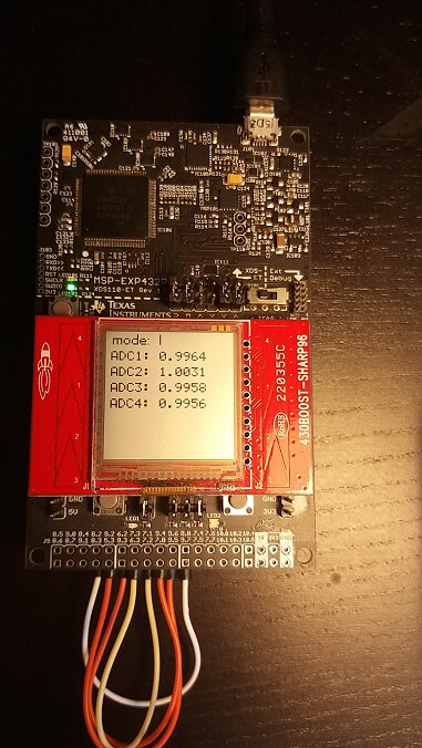

LCD Display
Check here for a detailed explanation: LCD Display
The firmware supports SHARP LCD display,

Test:
*IDN?;SYST:ERR:COUN?
Should return
THEBREADBOARD,ELECTRONICLOAD,0,01.00;0

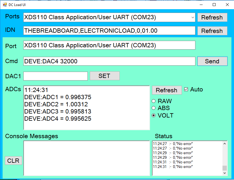

Windows GUI
There are two image. A .NET made by Peter, a Java version made by Jan.
The .net GUI supports reading the 4 ADCs, setting one of the DACs abd shoot any SCPI command.
There's a window for SCPI output and a status window that shows SCPI errors.
Source and binary available from https://github.com/thebreadboard/SCPI_DC_LOAD_WIN
The Java GUI is made as a POC that cross-platform instrument GUIs are possible.
It allows for switching the load on and off, set constant current and replicate the LCD values.
Additionally, you can requesst error status and run arbitrary SCPI commands.

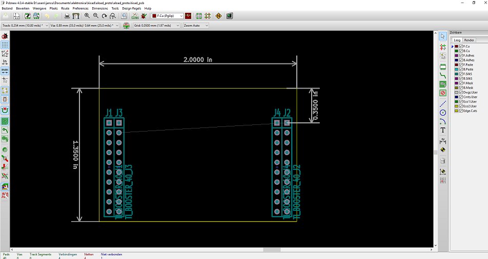

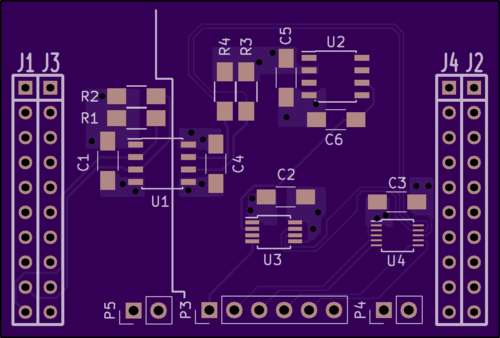

    Jan Cumps over 9 years ago in reply to Jan Cumps
    I have the 'isolated IC' part of the proto routed. What I'm trying to get here is a testable setup of your Raspberry Pi design.
    I don't try to get a dense board layout here, just something that's easy to probe and bodge when needed.
    The two footprints on the background are VCC and GND isolation. When populated, the LaunchPad powers the isolated side. When not populated, an external source has to provide it.
    schematic for ADC/DAC prototype
