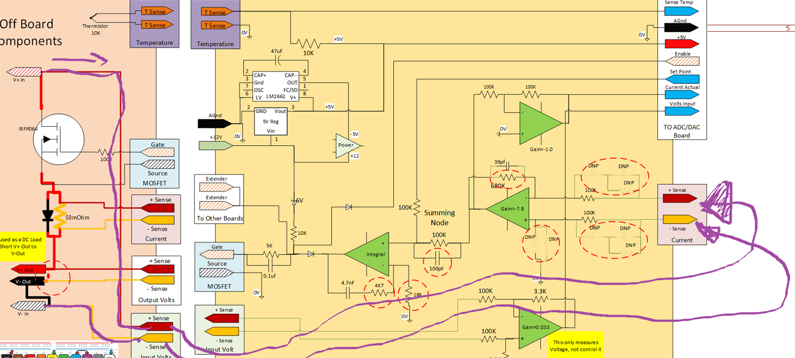

Peter, Jon and Jan are building a programmable electronic load. This document is the common design sheet.
It's obviously work in progress. And fun.
We're building a programmable DC load. The focus is on making a real world working instrument.
Hardware and firmware are open source.

Analog Controller and Driver Board
This is the core of the analog constant current block. Here lives the circuit that will translate desired constant current into the driver signal for the power MOSFET.
It integrates the feedback coming from that power board. This is a closed analog control loop.
There are also components to provide the on-off functionality and buffers/amplifiers for the analog data-points that fly back to the ADC module.
The board, schematics and BOM are documented in Programmable Electronic Load - Analog Controller and Driver Board.
Power Module - the MOSFET Board with Fan
For details  of the design of the power stage, check Programmable Electronic Load - Power Stage.

    I've added a voltage divider for the voltage sense to our to-do list. Depending on the voltage range we accept, we'll need a (fairly stable) divider that takes care that the DAC input sees a level within its range. Maybe with a zener diode over the sense pins to protect the DAC from overvoltage...
  • jc2048
    jc2048 over 9 years ago in reply to Jan Cumps
    You can change the gain of the differential amplifier if you need a different voltage range.
    As it stands, it gets you to 60V (if the ADC input range is 0-2V). If you want a range up to 100V, change the 100k resistors to 180k.
    Overvoltage protection comes from the input protection diodes. With a higher voltage in, they'll see a few milliamps and they'll cope, though it's not really how you should do the protection. A pair of back-to-back diodes across the input pins might be better.
  • jc2048
    jc2048 over 9 years ago in reply to jc2048
    Sorry, I misunderstood you. You mean after the differential amplifier, to limit the output swing seen by the ADC.
    Jan Cumps over 9 years ago in reply to jc2048
    No, I was talking about this voltage, but the 100Ks in series should do:
    edit: I wasn't using my brain here, it seems. See Jon's comment below for the correct connection. Don't know what I was thinking here ...

  • Robert Peter Oakes
    Robert Peter Oakes over 9 years ago in reply to jc2048
    Yes, that looks correct for the DC load version.
  • jc2048
    I understood Peter's scheme to be like this for the load. But I could be wrong, so check your wiring with him before you power up with whatever super-expensive MOSFET you choose use.
    Robert Peter Oakes over 9 years ago in reply to Robert Peter Oakes
    For information only, this is the earlier PSU design I had where the current and voltage are combined in one quad op-amp and has everything in one diagram. it lacks the temperature sense and the measurement of actual voltage or current.
    As you can see, I was also using very precise resistor values to maximise the ADC / DAC ability for 0-5V control voltages. this resulted in weird values that would need to have multiple selected resistors to obtain, the new design uses standard values (Selection may allow more accurate operation though image )
    Robert Peter Oakes over 9 years ago in reply to Jan Cumps
    This is the diagram in Current Mode, the voltage measurement is the V+ in (Input Volts block)  and as Jan said, it is for calculation purposes only, the middle right sense amp is connected to the current sense.
    in Voltage mode, this is the diagram
    here the voltage is controlled and as you can see the right middle connector is routed to the Output volts sense, if your in DC Load configuration, this is shorted out. when you combine the two as would be the case in a PSU, you can monitor the output volts, the output current, the RAW supply volts and of course the temperature of the heatsink or what ever you attach the thermistor to. Also when both are used, the second board does not connect to the mosfet using the mosfet connection, it uses the extender connection
    I am talking about the load. I was giving a PSU example because I don't have a load available to show it image.
    In Load mode, we should sense the voltage (for display and calculations only; we don't regulate it) from what we get over the terminals, and the current over the 50mOhm resistor?
  • jc2048
    OK, you're not talking about the load. But for the PSU configuration, the way you've drawn it you are measuring the unregulated, input voltage, not the regulated output voltage.
    Jan Cumps over 9 years ago in reply to Jan Cumps
    This is how it's done with a PSU:
    internally
    • M+ connects to the positive terminal
    • M- to the negative terminal
    • S+ to the voltage sense +
    • S- to the voltage sense -
    With the bridges in place, the voltage at the terminals goes directly to the voltage measure circuit,
    With the bridges, you connect S+ and S- to the device under test.
    We could do something similar. If not needed, we can just connect the sense wires directly to the load terminals.
