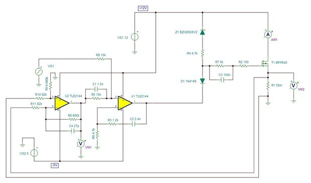

Analog Controller and Driver Board
This is the core of the analog constant current block. Here lives the circuit that will translate desired constant current into the driver signal for the power MOSFET.
It integrates the feedback coming from that power board. This is a closed analog control loop.
There are also components to provide the on-off functionality and buffers/amplifiers for the analog data-points that fly back to the ADC module.
The board, schematics and BOM are documented in Programmable Electronic Load - Analog Controller and Driver Board.

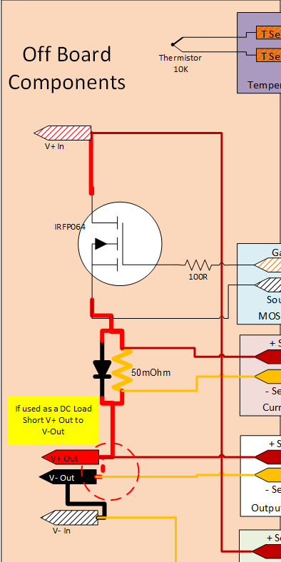

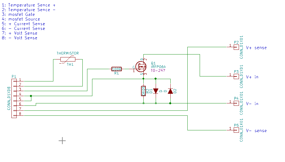

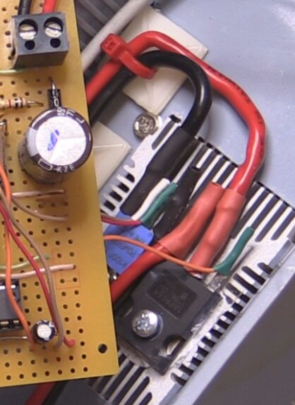

Power Module - the MOSFET Board with Fan
For details  of the design of the power stage, check Programmable Electronic Load - Power Stage.

    Robert Peter Oakes , for the off-board part, do you have advice on the components?
    In particular the thermistor, 0R05 resistor (If we support 5A, should be at least 1.25W, what precision?) and the diode (should it be a fast type?).
  • Robert Peter Oakes
    Robert Peter Oakes over 8 years ago in reply to Jan Cumps
    I think what is important is its stability rather than its accuracy, going for a 1% or better is probably OK, but a high stab version, this is especially true if you have a means to measure the actual value to say 0.1% or better, if it is stable over a temperature range then software can take care of the calibration, I would also up the wattage to say 5W or more, it will be more stable and require less additional cooling and this will of course help with stability.
    I was provided quite a while back a set of Vishay precision power resistors (0.1% and 1%, 4 terminal) and also a few select values of precision voltage dividers were the tolerance is better than 0.01% and ultra stable so getting an exact 0 - 500mV from a 5 Volt reference is easy for me.
    but as I said, stability is more important then absolute accuracy as that can be calibrated in software
    Regards
    Peter
    Robert Peter Oakes over 8 years ago in reply to Robert Peter Oakes
    For the thermistor, pretty much any should work as long as it handles the range of ambient to say 150deg. the kind used for 3D printer heads or beds should work a treat and there is plenty of code examples with lookup tables to aid in getting pretty accurate readings from such a simple circuit, this is where I got my inspiration from for that part.
    The power MOSFET is an open thing, I have a few of the ones in the above picture but also a friendly sponsor of mine sent me some awesome power MOSFET that are just massive and very power friendly (Huge heat pad)
    IXYS IXFN140N30P N-channel MOSFET, 115 A, 300 V HiperFET, Polar, 4-Pin SOT-227BIXYS IXFN140N30P N-channel MOSFET, 115 A, 300 V HiperFET, Polar, 4-Pin SOT-227B
    IXYS IXTN46N50L N-channel MOSFET, 46 A, 500 V Linear, 4-Pin SOT-227BIXYS IXTN46N50L N-channel MOSFET, 46 A, 500 V Linear, 4-Pin SOT-227B
    I cant wait to try these
    Jan Cumps over 8 years ago in reply to Robert Peter Oakes
    Robert Peter Oakes, do you have a reference to the thermistor you’re using? I’ll order the same one then and program its characteristics into the firmware. I can make this functionality flexible for differen types but like to keep it consistent for the first setup.
    Ow, both the specs and the looks are great. You'd almost mount them on the outside of the case so that people can see them image.
    I'm thinking about using a transistor close to the IRFP064 that you show on your schema, preferably surface mount.
    I'd like to create a small PCB for the off-board parts (they aren't off-board anymore then, are they) that I can attach to a heatsink.
    The current sense resistor would not be placed on that board because I'd like to keep that one as cool as possible. But if I can place the thermistor on a shared big copper pad, that would be great and tidy ...
    I'm also thinking on designing a PCB to house the connectors and maybe the display and some buttons (capacitive?) but that's for later. I'll be happy when I have a working setup without frivolities.
    I was thinking about that, along with a Plexiglas window to protect the wires
    A small PCB would be good, still “Off Board” from the main boards though, not essential but good, in order to keep the POWER current etc away from the rest is the reason I placed the sense resistor close to the FET and nowhere near the op-amp board. So the shortest possible current path from the user terminal back to the user terminal, the only thing going to the control board is the sense voltage (Current) and the gate voltage, along with a ground connection so absolutely no issues with ground currents
    The sense resistor could be placed on the board but not mounted to the heat sink
    Hope that helps
    Peter
    Off board suggestions:
    The power MOSFET is an open thing, ...
    For this prototype, I'm suggesting NTCLE100E3NTCLE100E3, 10 K NTC thermistor because I have that one image. It came with adafruit's original Arduino experiment kits.
    It can have 150° in peaks, 125° continuous (although the FET is up to 175° - I may have to search for a better part - please suggest)
    The FET, a IFRP064 , 60V N Channel MOSFet,also from Vishay. That's the same one as in the original design.
    Chime in if you have a better suggestion.
