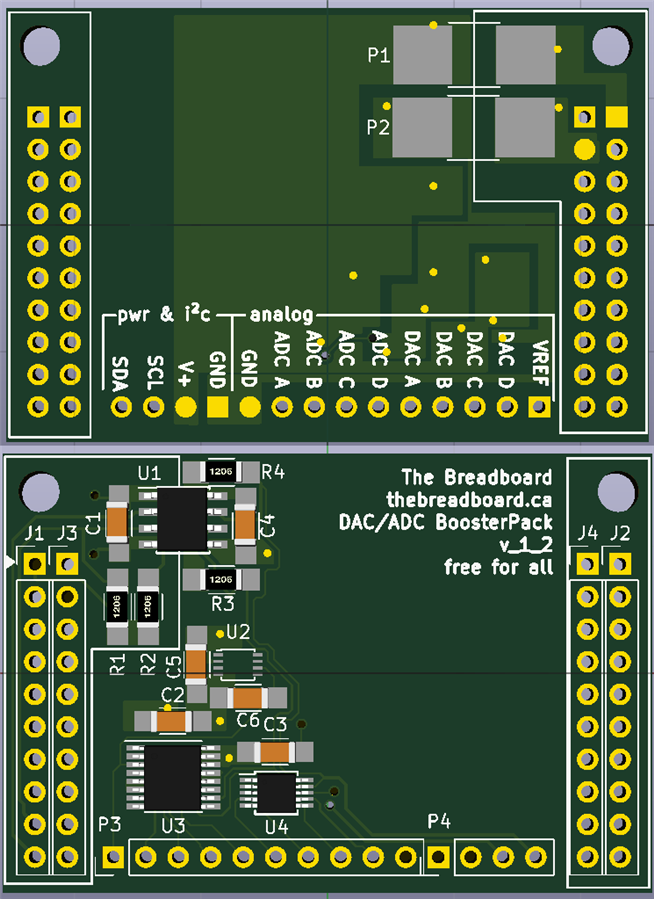

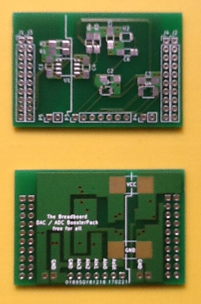

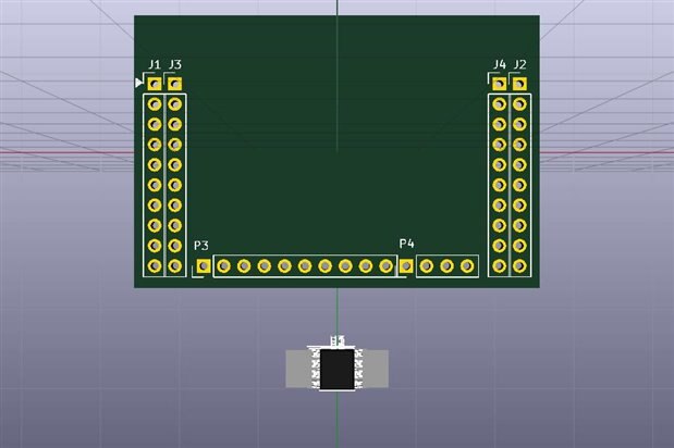

DAC-ADC BoosterPack
This module is a generic, isolated DAC / ADC boosterpack. It's the interface between the analog controller and the microcontroller.
It can also be used outside this project, for your other analog - digital conversion needs.
The board design is broken out in a separate post: Programmable Electronic Load - DAC / ADC BoosterPack.

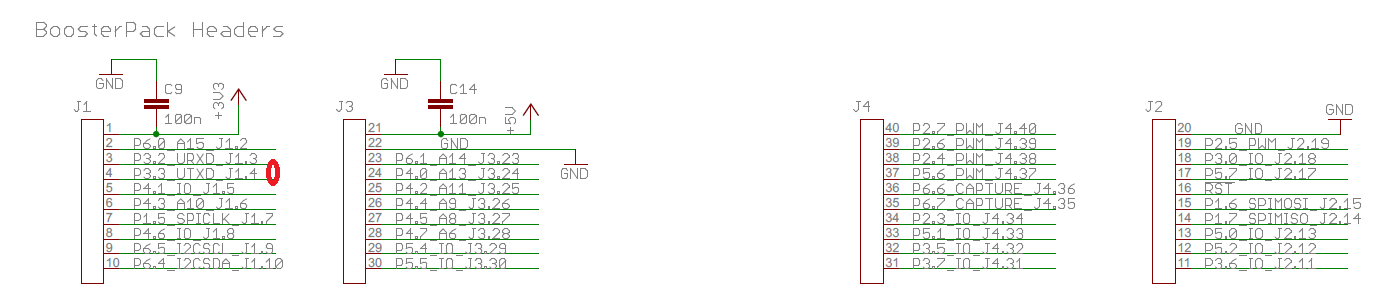

BoosterPack Header Use and Pin Allocation
This info is broken out in a separate post: Programmable Electronic Load - BoosterPack Header Use.

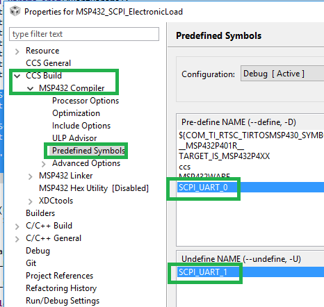

GIT artifacts don't contain CCS project files, only sources - get a zip with CCS project from the attachments at the end of this document.
SCPI interface and Error Handling
The SCPI commands are documented in this breakout post: SCPI interface.
UART Configuration
Together with SCPI, UART is the programming interface of this instrument.
The approach, and how to compile for USB or TTL, is documented in this breakout: UART.

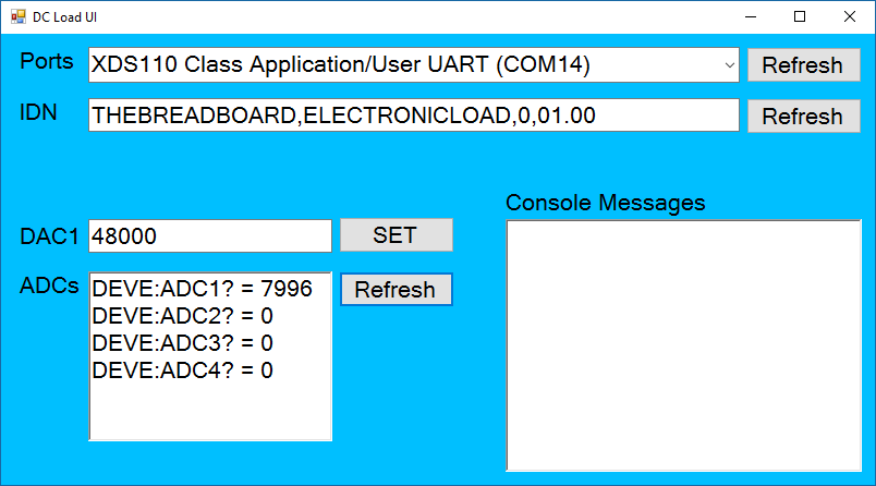

Windows GUI
There are two image. A .NET made by Peter, a Java version made by Jan.
The .net GUI supports reading the 4 ADCs, setting one of the DACs abd shoot any SCPI command.
There's a window for SCPI output and a status window that shows SCPI errors.
Source and binary available from https://github.com/thebreadboard/SCPI_DC_LOAD_WIN
The Java GUI is made as a POC that cross-platform instrument GUIs are possible.
It allows for switching the load on and off, set constant current and replicate the LCD values.
Additionally, you can requesst error status and run arbitrary SCPI commands.
