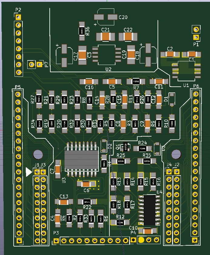

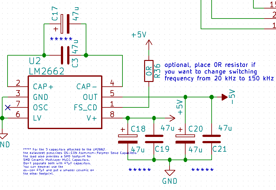

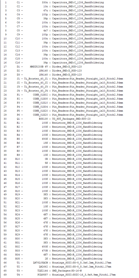

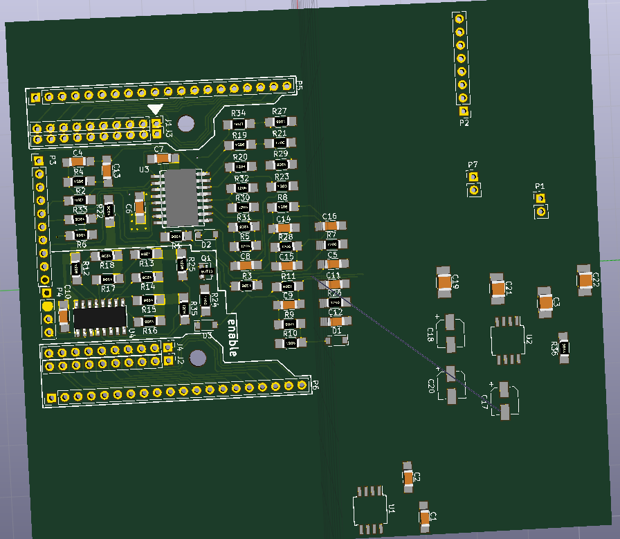

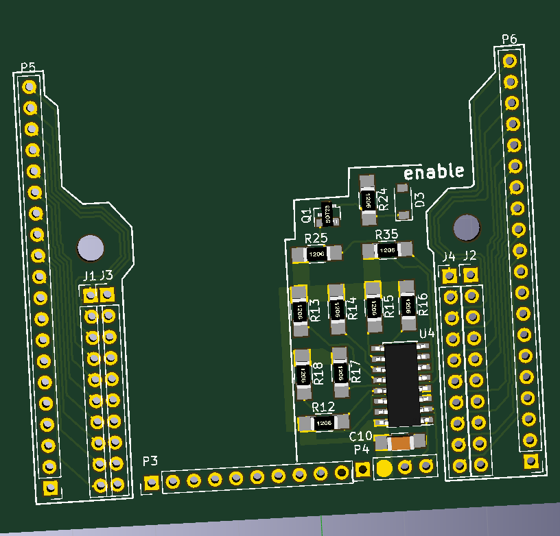

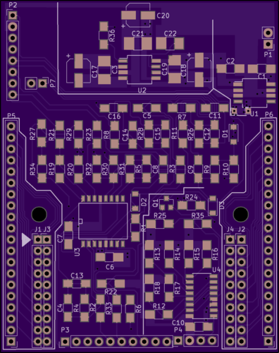

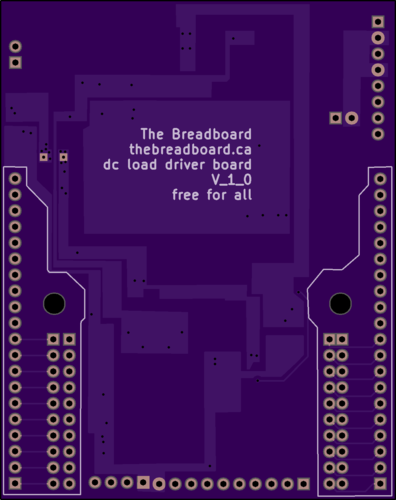

DAC-ADC BoosterPack
This module is a generic, isolated DAC / ADC boosterpack. It's the interface between the analog controller and the microcontroller.
It can also be used outside this project, for your other analog - digital conversion needs.
The board design is broken out in a separate post: Programmable Electronic Load - DAC / ADC BoosterPack.

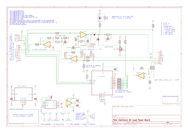

Analog Controller and Driver Board
This is the core of the analog constant current block. Here lives the circuit that will translate desired constant current into the driver signal for the power MOSFET.
It integrates the feedback coming from that power board. This is a closed analog control loop.
There are also components to provide the on-off functionality and buffers/amplifiers for the analog data-points that fly back to the ADC module.
The board, schematics and BOM are documented in Programmable Electronic Load - Analog Controller and Driver Board.

    I've copied the schema to KiCAD as a prep for pcb.
    There's two things missing: the enable circuit and the RC networks for PSU mode at current sence inputs.
    Would be great if you could check ...
    Optional boosterpack breakout for user interface components:

    Here's a first 'I think I've got it' version. I've done ERC validation to check all is connected, marked as unconnected where appropriate, and that all power related nets are driven.
    I'll upload the KiCAD project as a zip to the original post.
    What's not done:
    • the RC network around the current sence opamp
    • option to use OP491 CMOS quad opamp instead of TLE2144

    jc2048 over 8 years ago in reply to Jan Cumps
    R24 to 12V not 5V.
    Maybe consider resistor between output of U3B and pin 6 on the connector. The op-amp will run whatever its short-circuit current is into the protection on the A/D input if it swings negative (which would happen if you connected the load output the wrong way round and had current flowing the wrong way through the sense resistor).
    Optional, but 680k resistor from pin 12 of U3C to ground would balance up the two inputs better.

    Some good news. OP491 has a compatible SOIC footprint with TLE2144. There are two more pins on the 2144, but they are on one end and NC...
    Jan Cumps over 8 years ago in reply to jc2048
    Jon Clift wrote:
    R24 to 12V not 5V.
    fixed:
    What value do you suggest?
    fixed:
    Jan Cumps over 8 years ago in reply to Jan Cumps
    the OP491 option.
    different width though, but that's something I should be able to handle in the same PCB area.
    Don't know. A few hundred ohms, maybe. Since the op-amp has a -5V rail, a 470 ohm would limit the current to a maximum of about 10mA which is a reasonable figure for the protection to deal with if it had to.
  • jc2048
    OP491?
    I was simulating with an OPA192. Unless OP491 has been suggested by someone else.
    Unfortunately, the OPA192 is only available as a single, not a quad. (The OPA192 is a faster version of the OPA191 that MK introduced us to either earlier this year or last year. It gives precision and reasonable speed.)
    I'm not sure I should be designing your board like this. Including an extra resistor here and there for flexibility with the prototype is one thing, because they can always be left off, but Peter is the 'design authority' on the hardware and it ought to be his call what opamps you're using. If you design by committee, you get a hippogriffen as a result (or however the saying goes).
    a 470 ohm
    done
    I have IC dyslexia, it seems image.  I'll hold off from adding it. We can check this later.
    3 people isn't a committee. Committee needs an even number so you can get in an eternal design gridlock.
    I was thinking about adding only flex that adds options and doesn't interfere or slow down.
    I'll do a printout and review on paper this evening, then start with PCB layout. Whenever I can I'll use manageable packages - 1206, SOIC, SOT.
    I'm trying to keep it to a 2 layer board for cost reasons.

    preliminary BOM (click for decent resolution):

  • jc2048
    I have IC dyslexia, ...
    Now you tell us.
    To me, any number greater than 1 is a committee.
    The OPA192 is only available as a single device in a package not a quad, so you couldn't do a sensible design for both.
    You'll need decoupling on the input and the output of the LM2662. Electrolytics the same size as C3 is probably a good starting point. And get them close to the device. It would be a good idea to have placements for ceramic caps as well, as a very low ESR alternative.
    Pin 1 selects the switching frequency. If you make it so that it can be linked to +5, then you'll have the choice of 20kHz or 150kHz - currently it selects 20kHz. I don't know which is better. 20kHz will have more ripple, but 150kHz will couple around more as noise and is up in the area where the PSRR is falling rapidly (at least for the TLE device - the OPA device looks surprisingly good compared to anything I've ever seen before and I don't quite understand how they're doing the rejection at high frequency). Since the loading on the converter is very light, 20kHz might well be best, but I'd give myself the flexibility of choosing either for the prototype as it's so easy to do.
    As to the choice of a 2-layer board, maybe you should ask the experts what they think.
    Done.
    edit: need to rotate C20 !!
    for os-con: this one PANASONIC ELECTRONIC COMPONENTS - Capacitor, 47 µF, 16 V, OS-CON SVPG Series, Radial Can - SMD, 0.025 ohm, 5000 hours @ 105°CPANASONIC ELECTRONIC COMPONENTS - Capacitor, 47 µF, 16 V, OS-CON SVPG Series, Radial Can - SMD, 0.025 ohm, 5000 hours @ 105°C
    for ceramic: MURATA - SMD Multilayer Ceramic Capacitor, 1210 [3225 Metric], 47 µF, 16 V, ± 10%, X5R, GRM SeriesMURATA - SMD Multilayer Ceramic Capacitor, 1210 [3225 Metric], 47 µF, 16 V, ± 10%, X5R, GRM Series
    BOM:
    ReferenceValueFootprintP3CONN_01X10Pin_Headers:Pin_Header_Straight_1x10_Pitch2.54mmP4CONN_01X04Pin_Headers:Pin_Header_Straight_1x04_Pitch2.54mmP1CONN_01X02Pin_Headers:Pin_Header_Straight_1x02_Pitch2.54mmU3TLE2144SMD_Packages:SO-16-WC6100nCapacitors_SMD:C_1206_HandSolderingC7100nCapacitors_SMD:C_1206_HandSolderingP2CONN_01X08Pin_Headers:Pin_Header_Straight_1x08_Pitch2.54mmR2210KResistors_SMD:R_1206_HandSolderingU2LM2662Housings_SOIC:SO-8_5.3x6.2mm_Pitch1.27mmU1LM78L05ACMHousings_SOIC:SO-8_5.3x6.2mm_Pitch1.27mmR2100KResistors_SMD:R_1206_HandSolderingR618KResistors_SMD:R_1206_HandSolderingR344K7Resistors_SMD:R_1206_HandSolderingD21N4148Diodes_SMD:D_SOD-123R115KResistors_SMD:R_1206_HandSolderingR1100KResistors_SMD:R_1206_HandSolderingR3100KResistors_SMD:R_1206_HandSolderingR4100KResistors_SMD:R_1206_HandSolderingR5680KResistors_SMD:R_1206_HandSolderingC4100pCapacitors_SMD:C_1206_HandSolderingC84n7Capacitors_SMD:C_1206_HandSolderingC9100pCapacitors_SMD:C_1206_HandSolderingC1330nCapacitors_SMD:C_1206_HandSolderingC210nCapacitors_SMD:C_1206_HandSolderingC539pCapacitors_SMD:C_1206_HandSolderingR7100KResistors_SMD:R_1206_HandSolderingR8100KResistors_SMD:R_1206_HandSolderingR910KResistors_SMD:R_1206_HandSolderingD1MMSZ5233B 6VDiodes_SMD:D_SOD-123R21100KResistors_SMD:R_1206_HandSolderingR23100KResistors_SMD:R_1206_HandSolderingR193K3Resistors_SMD:R_1206_HandSolderingR203K3Resistors_SMD:R_1206_HandSolderingD31N4148Diodes_SMD:D_SOD-123R100RResistors_SMD:R_1206_HandSolderingQ1BSS138TO_SOT_Packages_SMD:SOT-23U4PCA9557Housings_SOIC:SOIC-16_3.9x9.9mm_Pitch1.27mmR352KResistors_SMD:R_1206_HandSolderingC10100nCapacitors_SMD:C_1206_HandSolderingR244K7Resistors_SMD:R_1206_HandSolderingR254K7Resistors_SMD:R_1206_HandSolderingR12100KResistors_SMD:R_1206_HandSolderingR13100KResistors_SMD:R_1206_HandSolderingR14100KResistors_SMD:R_1206_HandSolderingR15100KResistors_SMD:R_1206_HandSolderingR16100KResistors_SMD:R_1206_HandSolderingR17100KResistors_SMD:R_1206_HandSolderingR18100KResistors_SMD:R_1206_HandSolderingR32680KResistors_SMD:R_1206_HandSolderingR33470RResistors_SMD:R_1206_HandSolderingC347uCapacitors_SMD:C_1210_HandSolderingC1947uCapacitors_SMD:C_1210_HandSolderingC2147uCapacitors_SMD:C_1210_HandSolderingC1747uCapacitors_SMD:CP_Elec_5x5.3C2047uCapacitors_SMD:CP_Elec_5x5.3C1847uCapacitors_SMD:CP_Elec_5x5.3R360RResistors_SMD:R_1206_HandSolderingJ1Ti_Booster_40_J1Pin_Headers:Pin_Header_Straight_1x10_Pitch2.54mmJ2Ti_Booster_40_J2Pin_Headers:Pin_Header_Straight_1x10_Pitch2.54mmJ3Ti_Booster_40_J3Pin_Headers:Pin_Header_Straight_1x10_Pitch2.54mmJ4Ti_Booster_40_J4Pin_Headers:Pin_Header_Straight_1x10_Pitch2.54mmP5CONN_01X20Pin_Headers:Pin_Header_Straight_1x20_Pitch2.54mmP6CONN_01X20Pin_Headers:Pin_Header_Straight_1x20_Pitch2.54mmC1139pCapacitors_SMD:C_1206_HandSolderingC12100nCapacitors_SMD:C_1206_HandSolderingR2647KResistors_SMD:R_1206_HandSolderingC1439pCapacitors_SMD:C_1206_HandSolderingC15100nCapacitors_SMD:C_1206_HandSolderingR2847KResistors_SMD:R_1206_HandSolderingR303K3Resistors_SMD:R_1206_HandSolderingC1639pCapacitors_SMD:C_1206_HandSolderingR313K3Resistors_SMD:R_1206_HandSolderingC13100nCapacitors_SMD:C_1206_HandSolderingR2747KResistors_SMD:R_1206_HandSolderingR2947KResistors_SMD:R_1206_HandSoldering
    Value FootprintAantal - Reference0RResistors_SMD:R_1206_HandSoldering2100KResistors_SMD:R_1206_HandSoldering15100nCapacitors_SMD:C_1206_HandSoldering6100pCapacitors_SMD:C_1206_HandSoldering210KResistors_SMD:R_1206_HandSoldering210nCapacitors_SMD:C_1206_HandSoldering118KResistors_SMD:R_1206_HandSoldering11N4148Diodes_SMD:D_SOD-12322KResistors_SMD:R_1206_HandSoldering1330nCapacitors_SMD:C_1206_HandSoldering139pCapacitors_SMD:C_1206_HandSoldering43K3Resistors_SMD:R_1206_HandSoldering4470RResistors_SMD:R_1206_HandSoldering147KResistors_SMD:R_1206_HandSoldering447uCapacitors_SMD:C_1210_HandSoldering3Capacitors_SMD:CP_Elec_5x5.334K7Resistors_SMD:R_1206_HandSoldering34n7Capacitors_SMD:C_1206_HandSoldering15KResistors_SMD:R_1206_HandSoldering1680KResistors_SMD:R_1206_HandSoldering2BSS138TO_SOT_Packages_SMD:SOT-231CONN_01X02Pin_Headers:Pin_Header_Straight_1x02_Pitch2.54mm1CONN_01X04Pin_Headers:Pin_Header_Straight_1x04_Pitch2.54mm1CONN_01X08Pin_Headers:Pin_Header_Straight_1x08_Pitch2.54mm1CONN_01X10Pin_Headers:Pin_Header_Straight_1x10_Pitch2.54mm1CONN_01X20Pin_Headers:Pin_Header_Straight_1x20_Pitch2.54mm2LM2662Housings_SOIC:SO-8_5.3x6.2mm_Pitch1.27mm1LM78L05ACMHousings_SOIC:SO-8_5.3x6.2mm_Pitch1.27mm1MMSZ5233B 6VDiodes_SMD:D_SOD-1231PCA9557Housings_SOIC:SOIC-16_3.9x9.9mm_Pitch1.27mm1Ti_Booster_40_J1Pin_Headers:Pin_Header_Straight_1x10_Pitch2.54mm1Ti_Booster_40_J2Pin_Headers:Pin_Header_Straight_1x10_Pitch2.54mm1Ti_Booster_40_J3Pin_Headers:Pin_Header_Straight_1x10_Pitch2.54mm1Ti_Booster_40_J4Pin_Headers:Pin_Header_Straight_1x10_Pitch2.54mm1TLE2144SMD_Packages:SO-16-W1Totaal Resultaat 75
  • jc2048
    Thinking further, since the oscillator frequency can be changed by adding a capacitor from pin 7 to ground, why not put a placement there too.
    I find having the PSU-only stuff (just a few passive components) on a separate sheet confusing. Isn't it possible to incorporate them into the main circuit? If you're too pushed for space, maybe you could swap the PCA9557 and the power stuff (U1 and U2) to a sheet of its own.
    Labelling of P2
    1: Sence +
    2: Sence -
    This is the connections to the thermistor? Might be worth labelling it as such.
    I will add it.
    That's because they are supposed to be on heatsinks and cooled with a fan, maybe at the back of the instrument. Putting these on the PCB would make mechanical build assumptions.
    It's also the intention that you can parallel several of these power parts to allow higher power dissipation. That's drawn on Peter's schematic. I haven't taken it over.I should add a 2 pin connector for that.
    Labelling of P2
    1: Sence +
    2: Sence -
    I will add that.
    jancumps wrote:
    Guess I misunderstood the remark. I moved to another sheet for opportunistic reasons. Adding them to the main sheet made that one more difficult to read. Since focus is on a load, I prefer the confusion to be on the PSU side.
    I tried to move all power related blocks to a hierarchical sheet but haven't been successful up until now. I'd have to read the manual to see how I can push parts of the main sheet to a sub-sheet after they have been drawn.
    boosterpack dock and enable circuit done
