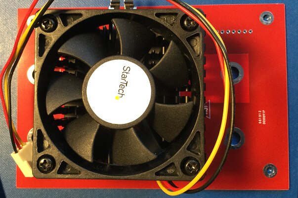

Power Module - the MOSFET Board with Fan
For details  of the design of the power stage, check Programmable Electronic Load - Power Stage.

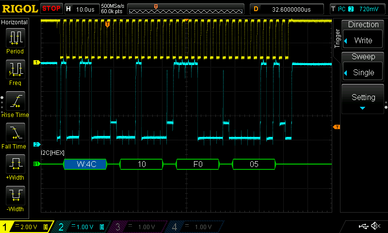

ADC, DAC and Enable are all I2C driven.

DAC output is set on command, using RTOS MailBox and messaging.
The payload for a DAC message contains the DAC channel that needs to be set, and the value.
typedef struct MsgDAC {
    uint8_t module;
    uint16_t value;
} MsgDAC;
The DAC task is started by RTOS. It inialises the DAC settings, then waits until it receives a message.

            d_dactxBuffer[0] = getAddressFromModule(d_msg.module); // set value direct
            d_dactxBuffer[1] = d_msg.value >> 8; // MSB
            d_dactxBuffer[2] = d_msg.value; // LSB
            if (! I2C_transfer(i2c_implGetHandle(), &d_daci2cTransaction)) {
//                System_printf("I2C Bus fault\n");
//                System_flush();
You select the DAC channel by setting bit 2 and 1 in the control byte (tx_buffer[0]). There's a helper function that gives a correct control record.
// address 7 - 6: 0, load mode 5 - 4: 01 direct from i2c, 3: reserved 0, 2 - 1: channel select, 0: pwr down 0
