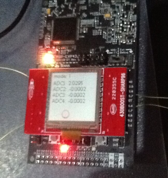

LCD Display
Check here for a detailed explanation: LCD Display
The firmware supports SHARP LCD display,

    Jan Cumps over 9 years ago
    LCD display integration - value 1 real, 2 -> mock
    The samples are stored in their raw value that we pull off the ADC:
                adcRoundRobin[adcRoundRobinIndex ? 0 : 1].raw[0] = ((a_rxBuffer[0] << 8) | a_rxBuffer[1]);
    I've provided two helper functions that deal with formatting in Value and Voltage:
    uint16_t adcImplToValue(uint16_t uRaw){
        // todo: remove - this is for peter Oakes' testbed
        if (uRaw == 0xFFFF) {
            return 0xFFFF;
        uint16_t        ADCValue;
        bool            ValNegative = false;
        ADCValue = uRaw;
        ValNegative = (0x8000&ADCValue ? true : false);
        ADCValue = (ValNegative ? 0x8000 - (int)(0x7FFF&ADCValue) : ADCValue) ;
        return ADCValue;
    float adcImplToFloat(uint16_t uRaw) {
        uint16_t        ADCValue;
        float           ADCVoltage;
        ADCValue = uRaw;
        ADCVoltage = (ValNegative ? (ADCValue * VPS) *-1: ADCValue * VPS ) ;
        return ADCVoltage;
    In the SCPI part for example, the Raw -> Display looks like this:
    uint32_t eLoadDevelopGetAdc(uint32_t uModule) {
        return adcImplToValue(adcImplGetAdc(uModule));
    In the LCD display code, where we use float voltage:
               sprintf(formatString, "ADC%i: %02.4f\0", i + 1, adcImplToFloat(adcImplGetAdc(i)));
    If we run out of processor time or code space, we can do the conversions at sample time and store them next to the raw value.
    We store in a structure anyway, so adding 2 fields isn't hard..
    It's a trade-off we can do when and if needed.
