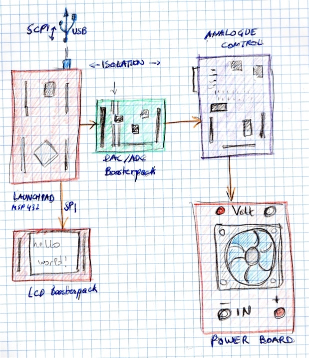

Hardware
The load design is modular.
Two out of box modules:
  • MSP432 LaunchPad
  • LCD Shield (optional)
3 new designs
  • DAC-ADC module
  • Analog control module
  • Power module

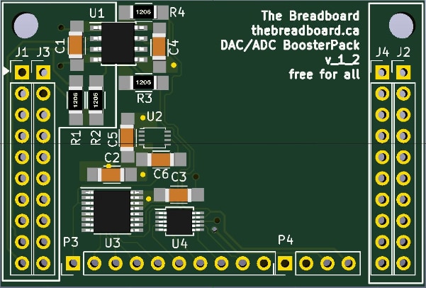

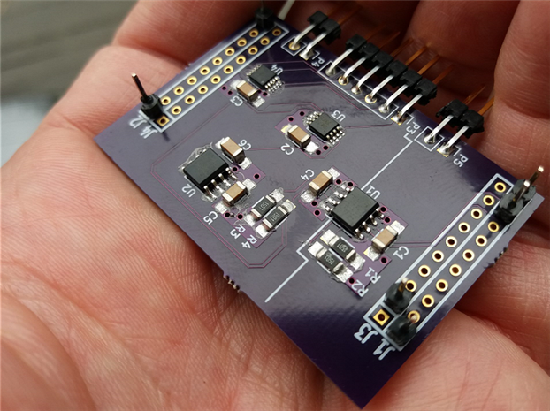

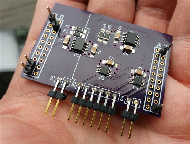

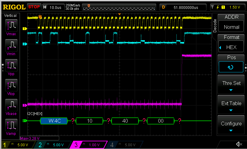

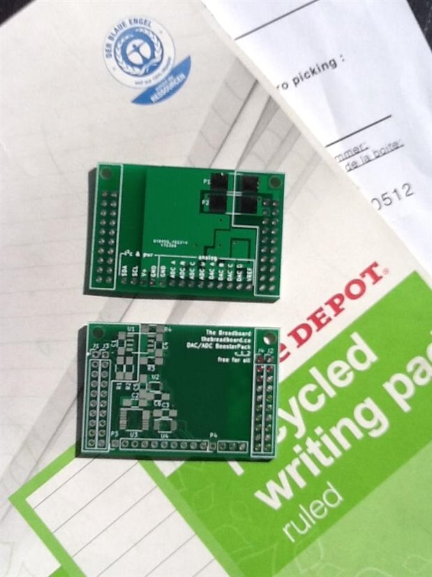

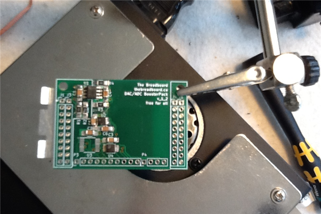

DAC-ADC BoosterPack
This module is a generic, isolated DAC / ADC boosterpack. It's the interface between the analog controller and the microcontroller.
It can also be used outside this project, for your other analog - digital conversion needs.
The board design is broken out in a separate post: Programmable Electronic Load - DAC / ADC BoosterPack.

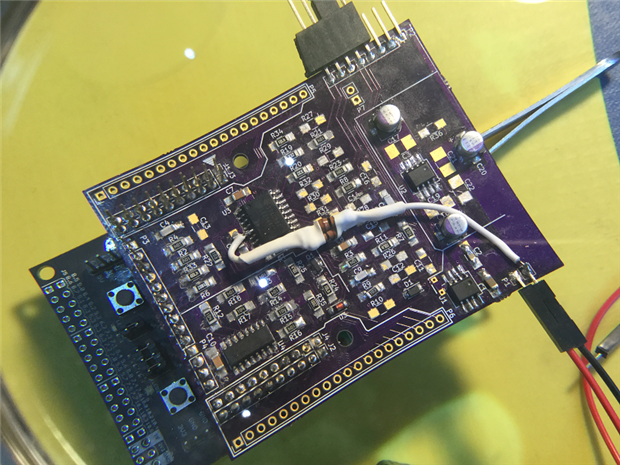

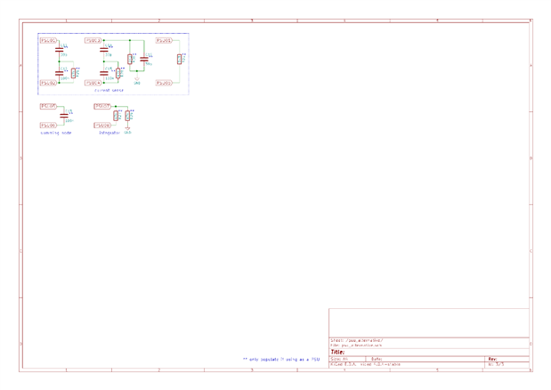

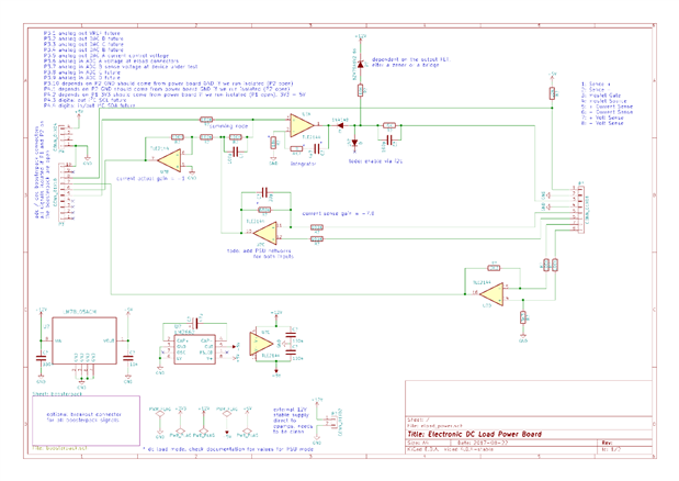

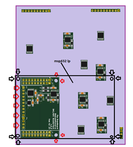

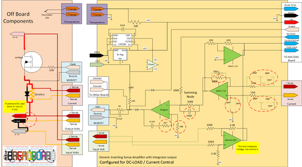

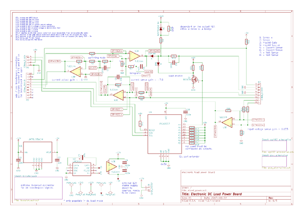

Analog Controller and Driver Board
This is the core of the analog constant current block. Here lives the circuit that will translate desired constant current into the driver signal for the power MOSFET.
It integrates the feedback coming from that power board. This is a closed analog control loop.
There are also components to provide the on-off functionality and buffers/amplifiers for the analog data-points that fly back to the ADC module.
The board, schematics and BOM are documented in Programmable Electronic Load - Analog Controller and Driver Board.

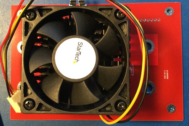

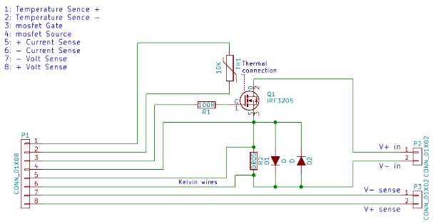

Power Module - the MOSFET Board with Fan
For details  of the design of the power stage, check Programmable Electronic Load - Power Stage.

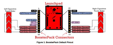

BoosterPack Header Use and Pin Allocation
This info is broken out in a separate post: Programmable Electronic Load - BoosterPack Header Use.

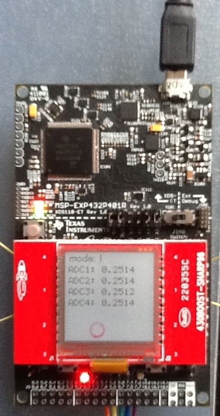

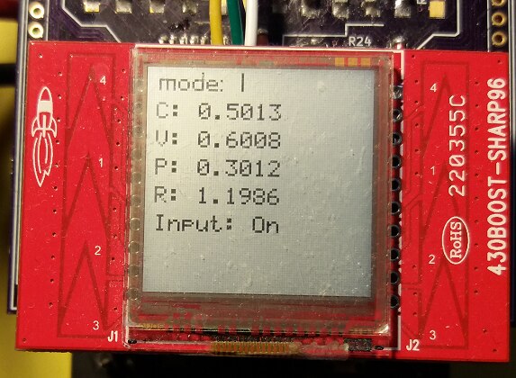

LCD Display
Check here for a detailed explanation: LCD Display
The firmware supports SHARP LCD display,

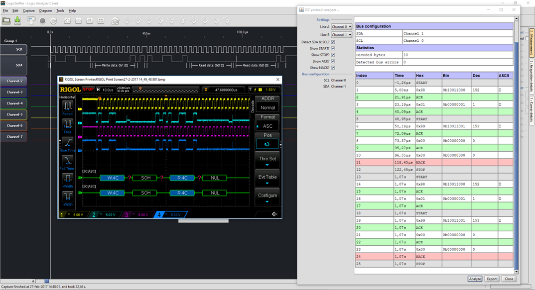

ADC
I've broken out the ADC description to a separate post, because I'm working on improvements:
Programmable Electronic Load - ADC Firmware
DAC
DAC output is set on command, using RTOS MailBox and messaging.
The payload for a DAC message contains the DAC channel that needs to be set, and the value.
typedef struct MsgDAC {
    uint8_t module;
    uint16_t value;
} MsgDAC;
The DAC task is started by RTOS. It inialises the DAC settings, then waits until it receives a message.
void *threadDAC(void *arg0) {
    MsgDAC d_msg;
    d_daci2cTransaction.writeBuf = d_dactxBuffer;
    d_daci2cTransaction.readBuf = d_dacrxBuffer;
    d_daci2cTransaction.slaveAddress = DAC_I2C_ADDR;
    d_daci2cTransaction.writeCount = 3;
    d_daci2cTransaction.readCount = 0;
    mqd_t mq;
    struct mq_attr attr;
    attr.mq_flags = 0;
    attr.mq_maxmsg = 1;
    attr.mq_msgsize = MSGDAC_SIZE;
    attr.mq_curmsgs = 0;
    mq = mq_open(QUEUE_NAME_DAC, O_CREAT | O_RDONLY, 0644, &attr);
    while (1) {
        ssize_t bytes_read;
        bytes_read = mq_receive(mq, (char *)&d_msg, MSGDAC_SIZE, NULL);
        /* wait for mailbox to be posted by writer() */
        if (bytes_read) {
The waiting doesn't take processor time. RTOS takes care that it will only get a slice of clock cycles when there is a message.
Two things in the RTOS configuration make this happen:
The mailbox with room for exactly one message, and a receive event.
Because there is usually no message in the mailbox, the execution of the DAC logic becomes inactive at this line:
When we send a DAC message somewhere else in the code (e.g.: when the user requests a new setting of the electronic load), RTOS reactivates the process and hands over the payload message.
The DAC task sets the output of the requested channel and returns to the point where it waits for a new message.
   while (1) {
        ssize_t bytes_read;
        if (bytes_read) {
            d_dactxBuffer[0] = getAddressFromModule(d_msg.module); // set value direct
            d_dactxBuffer[1] = d_msg.value >> 8; // MSB
            d_dactxBuffer[2] = d_msg.value; // LSB
            if (! I2C_transfer(i2c_implGetHandle(), &d_daci2cTransaction)) {
//                System_printf("I2C Bus fault\n");
//                System_flush();

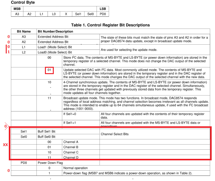

You select the DAC channel by setting bit 2 and 1 in the control byte (tx_buffer[0]). There's a helper function that gives a correct control record.
// address 7 - 6: 0, load mode 5 - 4: 01 direct from i2c, 3: reserved 0, 2 - 1: channel select, 0: pwr down 0
#define DAC857X_CFG_H0 0b00010000
#define DAC857X_CFG_H1 0b00010010
#define DAC857X_CFG_H2 0b00010100
#define DAC857X_CFG_H3 0b00010110
static const uint8_t array_DAC857X_CFG_H[4] = {DAC857X_CFG_H0, DAC857X_CFG_H1, DAC857X_CFG_H2, DAC857X_CFG_H3};
 * get the hex address for the requested DAC module
uint8_t getAddressFromModule(uint8_t module) {
    return array_DAC857X_CFG_H[module];
Bits 7 - 3 and 0 are all fixed.

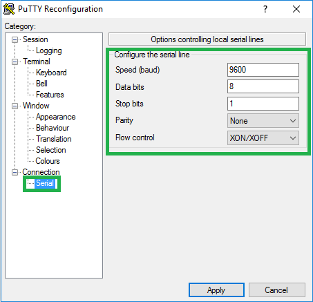

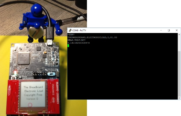

Remote Software

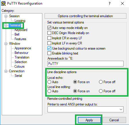

Teminal
Serial communication to the USB UART port.
9600/8/1/None
SCPI is a non-echoing protocol. To make the characters you type show in the Terminal, set Local echo to Force on.
If you also set Local line editing to Force on, you have the opportunity to correct characters in the current line before they are sent to the serial port.
Test:
*IDN?;SYST:ERR:COUN?
Should return
THEBREADBOARD,ELECTRONICLOAD,0,01.00;0

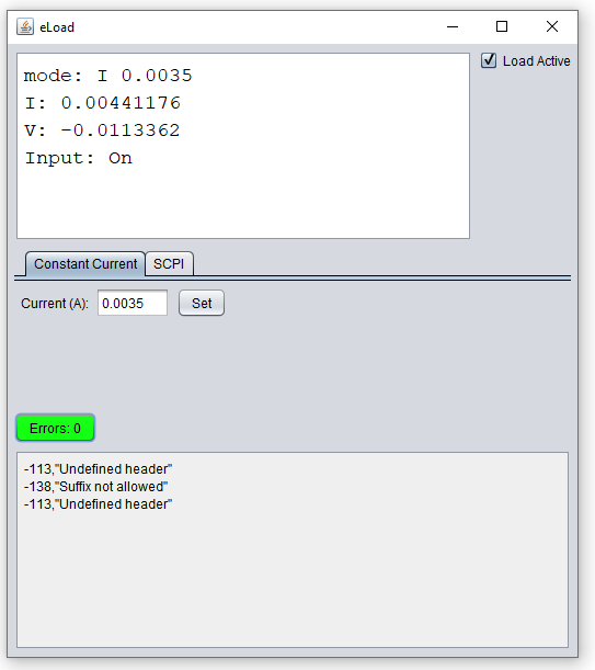

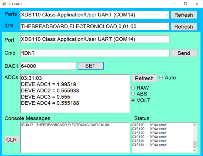

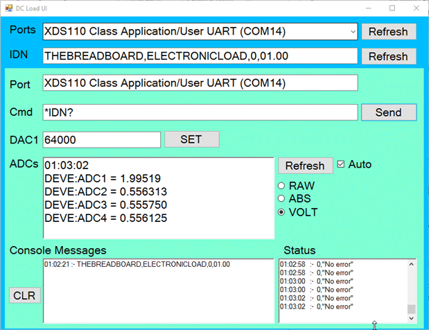

Windows GUI
There are two image. A .NET made by Peter, a Java version made by Jan.
The .net GUI supports reading the 4 ADCs, setting one of the DACs abd shoot any SCPI command.
There's a window for SCPI output and a status window that shows SCPI errors.
Source and binary available from https://github.com/thebreadboard/SCPI_DC_LOAD_WIN
The Java GUI is made as a POC that cross-platform instrument GUIs are possible.
It allows for switching the load on and off, set constant current and replicate the LCD values.
Additionally, you can requesst error status and run arbitrary SCPI commands.

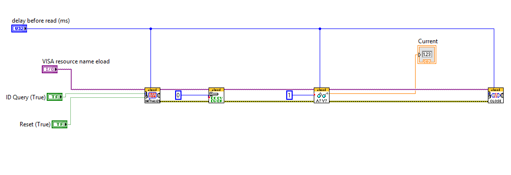

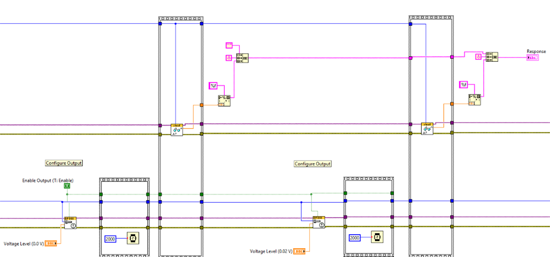

LabVIEW
The instrument comes with a LabVIEW library: Programmable Electronic Load - Write a LabVIEW Library part 1: Initialise Block

    Revisiting the eLoad design - there's definitely room for approval. The very low currency (minus 3 mA) is awful. And the calibration is off. I've set it to 0.5 A- and it thinks it's drawing that current…
    Jan Cumps over 9 years ago in reply to Jan Cumps +3

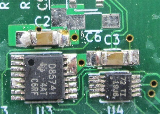

    All components are now in and soldered. Time to test. I'll first check out the power rails in isolation. If they are ok. I'll mount LaunchPad, LCD and and DAC board and do measurements. Hang on

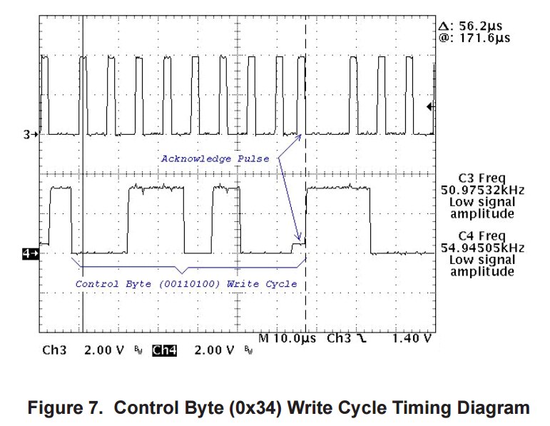

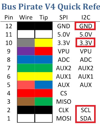

    Here's the Bus Pirate test script (read from ADC doesn't work yet):
    // menu
    m
    // i2c
    4
    // hardware
    2
    // 400 kHz
    2
    // 3v3 power supply on
    W
    // adc set 1/4 of vref
    [ 0x98 0x10 0x40 0x00]
    // dac set single shot, a0
    [ 0x90 0x01 0x03 0x05]
    // dac read result (read 2 bytes)
    [ 0x90 0x00] [0x91 r:2]
    // 3v3 power supply off
    w
    I have the following issues at the moment:
    • I don't get a good value yet
    • the first read returns bogus values
    • the second time I try to run the ADC commands again, blocks at read
    I2C>[ 0x90 0x01 0x03 0x05]
    I2C START BIT
    WRITE: 0x90 ACK
    WRITE: 0x01 ACK
    WRITE: 0x03 ACK
    WRITE: 0x05 ACK
    I2C STOP BIT
    I2C>[ 0x90 0x00] [0x91 r:2]
    I2C START BIT
    WRITE: 0x90 ACK
    WRITE: 0x00 ACK
    WRITE: 0x91 ACK
    READ: 0x00  ACK 0x00
    NACK
    I2C STOP BIT

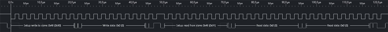

    DAC and ADC scenario.
    I've used your code from youtube:
    > 49 01 03 C w
    > 49 0 w
    I'm not sure why there is a w in the first line. Does the ADC reply a word when you execute that line?
    My code has address 0x48 because MSP432 will set the read/write bit itself
    I don't get any data back yet - was expecting something because I connected the DAC to the ADCs -- need to do some more investigation.
    #define DAC_I2C_ADDR           (0x4C)
    #define DAC_I2C               MSP_EXP432P401R_I2CB0
    #define ADC_I2C_ADDR           (0x48)
    #define ADC_I2C               MSP_EXP432P401R_I2CB0
    uint16_t Sin_tab[256] = {  32768,33572,34376,35178,35980,36779,37576,38370,39161,39947,40730,41507,42280,
                                   43046,43807,44561,45307,46047,46778,47500,48214,48919,49614,50298,50972,51636,
                                   52287,52927,53555,54171,54773,55362,55938,56499,57047,57579,58097,58600,59087,
                                   59558,60013,60451,60873,61278,61666,62036,62389,62724,63041,63339,63620,63881,
                                   64124,64348,64553,64739,64905,65053,65180,65289,65377,65446,65496,65525,65535,
                                   65525,65496,65446,65377,65289,65180,65053,64905,64739,64553,64348,64124,63881,
                                   63620,63339,63041,62724,62389,62036,61666,61278,60873,60451,60013,59558,59087,
                                   58600,58097,57579,57047,56499,55938,55362,54773,54171,53555,52927,52287,51636,
                                   50972,50298,49614,48919,48214,47500,46778,46047,45307,44561,43807,43046,42280,
                                   41507,40730,39947,39161,38370,37576,36779,35980,35178,34376,33572,32768,31964,
                                   31160,30358,29556,28757,27960,27166,26375,25589,24806,24029,23256,22490,21729,
                                   20975,20229,19489,18758,18036,17322,16617,15922,15238,14564,13900,13249,12609,
                                   11981,11365,10763,10174,9598,9037,8489,7957,7439,6936,6449,5978,5523,5085,4663,
                                   4258,3870,3500,3147,2812,2495,2197,1916,1655,1412,1188,983,797,631,483,356,247,
                                   159,90,40,11,1,11,40,90,159,247,356,483,631,797,983,1188,1412,1655,1916,2197,
                                   2495,2812,3147,3500,3870,4258,4663,5085,5523,5978,6449,6936,7439,7957,8489,9037,
                                   9598,10174,10763,11365,11981,12609,13249,13900,14564,15238,15922,16617,17322,
                                   18036,18758,19489,20229,20975,21729,22490,23256,24029,24806,25589,26375,27166,
                                   27960,28757,29556,30358,31160,31964};
     *  ======== taskFxn ========
     *  Task for this function is created statically. See the project's .cfg file.
    Void taskFxn(UArg arg0, UArg arg1)
        unsigned int    i;
        uint8_t         txBuffer[3];
        uint8_t         rxBuffer[2];
        I2C_Handle      i2c;
        I2C_Params      i2cParams;
        I2C_Transaction i2cTransaction;
        /* Create I2C for usage */
        I2C_Params_init(&i2cParams);
        i2cParams.bitRate = I2C_400kHz;
        i2c = I2C_open(DAC_I2C, &i2cParams);
        if (i2c == NULL) {
            System_abort("Error Initializing I2C\n");
        else {
            System_printf("I2C Initialized!\n");
        i2cTransaction.writeBuf = txBuffer;
        i2cTransaction.readBuf = rxBuffer;
        while (1) {
            for (i = 0; i< 256; i++) {
                // dac
                txBuffer[0] = 0x10;
                txBuffer[1] = Sin_tab[i] >> 8;
                txBuffer[2] = Sin_tab[i];
                if (I2C_transfer(i2c, &i2cTransaction)) {
                else {
                    System_flush();
                // adc
                i2cTransaction.slaveAddress = ADC_I2C_ADDR;
                txBuffer[0] = 0x01;
                txBuffer[1] = 0x03;
                txBuffer[2] = 0xC5;
                else {
                    System_flush();
                i2cTransaction.writeCount = 1;
                i2cTransaction.readCount = 2;
                txBuffer[0] = 0x00;
                    // rx 0 and 1 have the results
                else {
                    System_flush();
            Task_sleep(10);
        /* Deinitialized I2C */
        I2C_close(i2c);
        System_printf("I2C closed!\n");
        System_flush();
    Jan Cumps over 9 years ago in reply to Robert Peter Oakes
    Got it
  • Robert Peter Oakes
    Robert Peter Oakes over 9 years ago in reply to Jan Cumps
    I am suggesting to route pin 3 and 4 (4 is already done) to the header, this way the feedback sense can be carried all the way to the load and still maintain accuracy if desired
    Also a optional zero ohm resistor to simply connect on the board near the DAC if user does not want to extend the sense loop.

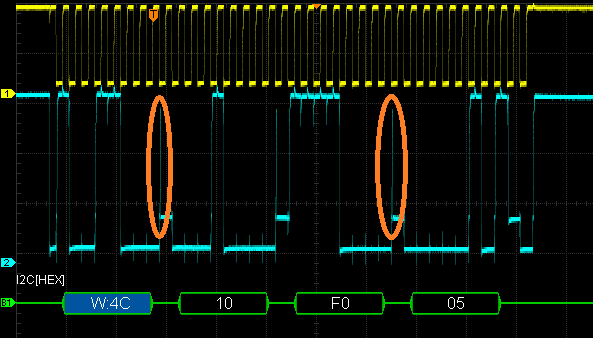

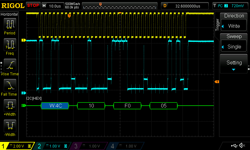

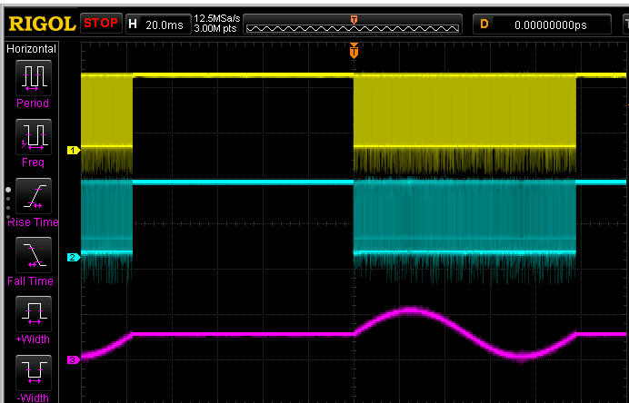

    for later reference. Time to set value:
    ... and with setting up the High and low byte, without yielding to the RTOS:
    second thoughts:
    that signal is already routed out. It's the DAC output. Am I (pin 4 of U3)  missing something?
    Peter Oakes wrote:
    on any new boards it would be good to bring it out to the header too, perhaps with a option of a zero ohm resistor on the board to leave it local.
    I can do that.
    So todo's:
    - connect U3 P3 and P4
    - route that signal to P3 (with 0R resistor)
    - DAC from 1 to 4 per packages, route all to P3
    todo: * need to connect U3 3 and 4 *
    Will be done in PCB 1.1
    (I ordered 10 pcbs of v1 for virtually no money from seeed because I had an expiring voucher.
    Bodging 3 and 4 with an iron and some solder is a 3 minute job.
    This is your arduino code ported to MSP432 with ti-rtos
