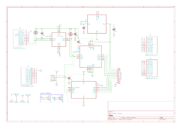

DAC-ADC BoosterPack
This module is a generic, isolated DAC / ADC boosterpack. It's the interface between the analog controller and the microcontroller.
It can also be used outside this project, for your other analog - digital conversion needs.
The board design is broken out in a separate post: Programmable Electronic Load - DAC / ADC BoosterPack.

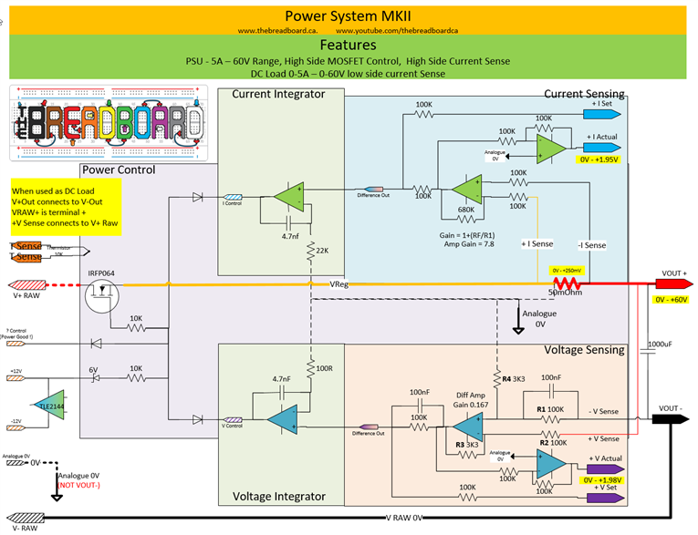

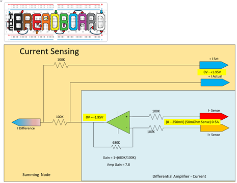

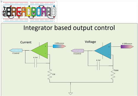

Analog Controller and Driver Board
This is the core of the analog constant current block. Here lives the circuit that will translate desired constant current into the driver signal for the power MOSFET.
It integrates the feedback coming from that power board. This is a closed analog control loop.
There are also components to provide the on-off functionality and buffers/amplifiers for the analog data-points that fly back to the ADC module.
The board, schematics and BOM are documented in Programmable Electronic Load - Analog Controller and Driver Board.

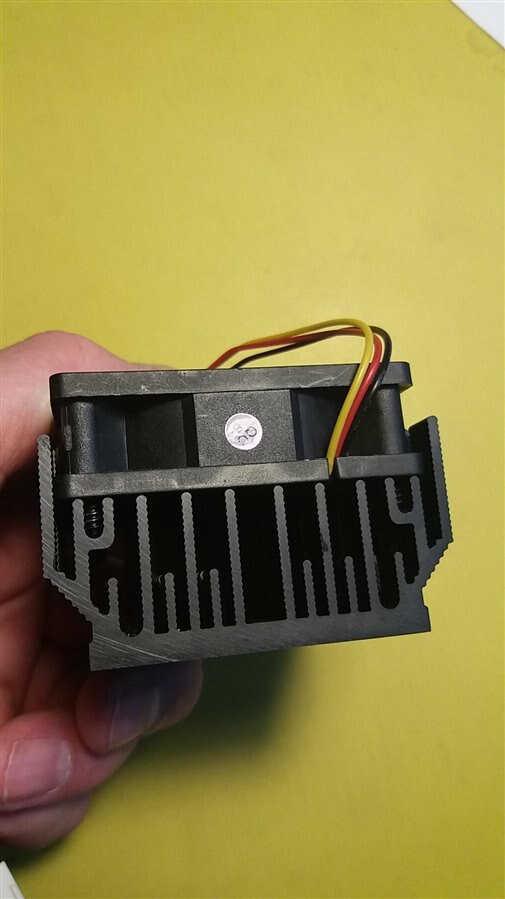

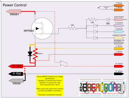

Power Module - the MOSFET Board with Fan
For details  of the design of the power stage, check Programmable Electronic Load - Power Stage.

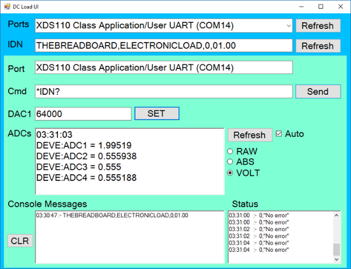

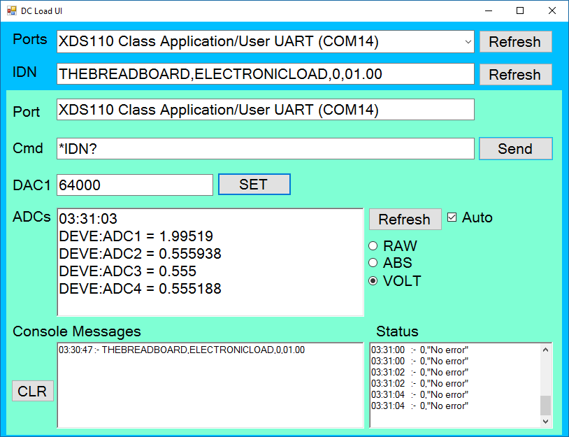

Windows GUI
There are two image. A .NET made by Peter, a Java version made by Jan.
The .net GUI supports reading the 4 ADCs, setting one of the DACs abd shoot any SCPI command.
There's a window for SCPI output and a status window that shows SCPI errors.
Source and binary available from https://github.com/thebreadboard/SCPI_DC_LOAD_WIN
The Java GUI is made as a POC that cross-platform instrument GUIs are possible.
It allows for switching the load on and off, set constant current and replicate the LCD values.
Additionally, you can requesst error status and run arbitrary SCPI commands.

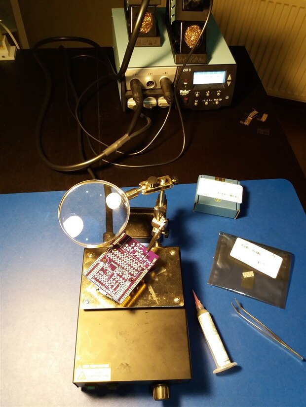

    All components are now in and soldered. Time to test. I'll first check out the power rails in isolation. If they are ok. I'll mount LaunchPad, LCD and and DAC board and do measurements. Hang on

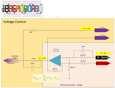

    OK, first cut at the DC Power schematic. This can serve 2 purposes, it will function as a power supply or a DC load. the only difference is 2 jumpers. and leaving out one set of op-amps
    Resistor Values chosen are to get close to full range of the 2.048 DAC output but still use standard resistor values. The ADC can be configured through the PGA to a suitable range
    The thermistor needs a 10K resistor adding and there will be a need for a 12V to 5V supply and a -5V to -12V for the op amps. I am thinking of using a capacitor inverter chip  http://www.ti.com/lit/ds/symlink/lm2765.pdf  to get the negative voltage and a simple 5V linear regulator for the +5 to feed to the DAC/ADC board.
    MOSFETS could be paralleled if needed to increase power handling. the opamps would run using +12 and -5V.
    The diagrams below have not been updated to show the inverting amps to correct the polarity of the V Actual and I Actual feedback to the ADC.

    Jan Cumps over 9 years ago in reply to Jan Cumps
    Omg: DAC8574IPW  $ 20.79
    quad DAC version.
    still with A0 pulled high and the latch pin unconnected
    Jan Cumps over 9 years ago in reply to Robert Peter Oakes

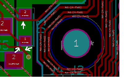

    Batch 2 of the PCB arrived from SEED. I'll mail a few.
    This is the one where the REF IC U2 has a VSOP footprint.
  • Robert Peter Oakes
    Robert Peter Oakes over 9 years ago in reply to Jan Cumps
    I heard about that stackable silicon, its cool to get all those chips so pin compatable
    Drastic measures for the quad-dac version
    Now that I have an example layout it's easier to start from a clean slate and optimise a few things while doing the new layout.
    The DAC and ADC fields work perfectly, also the error handling (type 65555 in DAC1 to test) and auto refresh and CMD field (tested with SYST:VERS?)..
    Maybe we can log nothing to Status field if the result is "-0"?
    The Ports box worked better in the previous version than in this one.
    When the app starts up, It selects the right com port but doesn't allow the Set or Refresh buttons (any communication gives COM port doesn't exist").
    Selecting the same port by hand from the list resolves it.
    Updated UI in Github with added features including polling for errors and ADC values. Also manual commands and now auto update for com port detection
