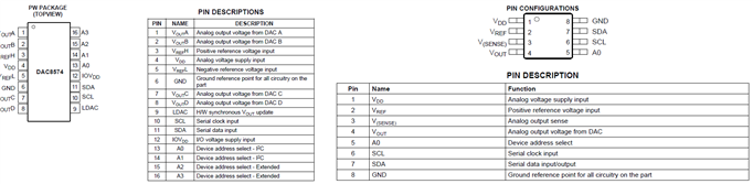

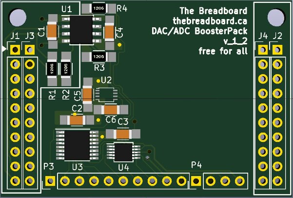

DAC-ADC BoosterPack
This module is a generic, isolated DAC / ADC boosterpack. It's the interface between the analog controller and the microcontroller.
It can also be used outside this project, for your other analog - digital conversion needs.
The board design is broken out in a separate post: Programmable Electronic Load - DAC / ADC BoosterPack.

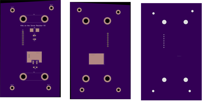

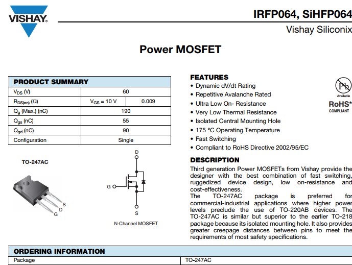

Power Module - the MOSFET Board with Fan
For details  of the design of the power stage, check Programmable Electronic Load - Power Stage.

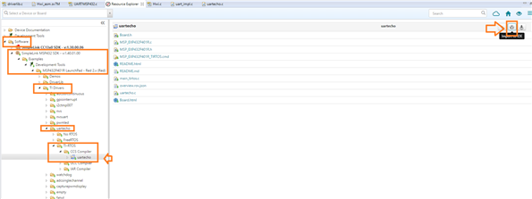

Firmware

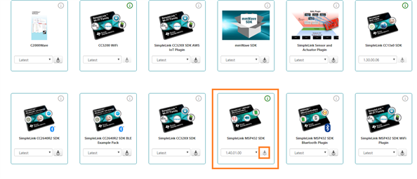

Prerequisites:
  • CCS 8 with MSP432 compiler TI v 16.12.0.STS or >
  • TI-RTOS for MSP43X, any SimpleLink version
  • MSP432 LaunchPad (not the black pre-prod because it's out of support)
The firmware is for the MSP432 microcontroller. But the harware can be driven from any controller, processor, PSoC or computer that can deliver i2c and power between 3V3 and 5V.
That includes Arduino, Raspberry Pi, BeagleBone, Warp7, IOT20xx, the ST Neo family, ... As long as they match that voltage range and have I2C master, it 'll work.
The ADC/DAC board takes care that the logic side is galvanicaly isolated from the power side (that is, if you leave the P1 and P2 jumpers open).
The only requirement is that you have a positive supply between 3V3 and 5V, a ground, and I2C signals (the board has I2C pull-ups that connect to the positive supply that you provide. If you don't want that (maybe your dev board already has 'm), leave R1 and R2 off.
ADC, DAC and Enable are all I2C driven.
GITHUB location: https://github.com/jancumps/msp432/tree/master/MSP432_SCPI_ElectronicLoad
download latest source files as a zip : https://github.com/jancumps/msp432/archive/master.zip
doxygen generated API documentation: https://jancumps.github.io/msp432
GIT artifacts don't contain CCS project files, only sources - get a zip with CCS project from the attachments at the end of this document.

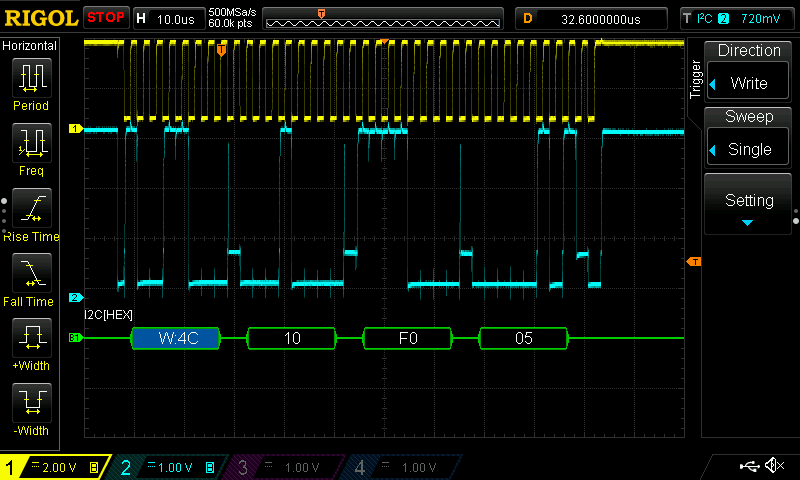

The DAC task is started by RTOS. It inialises the DAC settings, then waits until it receives a message.
void *threadDAC(void *arg0) {
    MsgDAC d_msg;
    d_daci2cTransaction.writeBuf = d_dactxBuffer;
    d_daci2cTransaction.readBuf = d_dacrxBuffer;
    d_daci2cTransaction.slaveAddress = DAC_I2C_ADDR;
    d_daci2cTransaction.writeCount = 3;
    d_daci2cTransaction.readCount = 0;
    mqd_t mq;
    struct mq_attr attr;
    attr.mq_flags = 0;
    attr.mq_maxmsg = 1;
    attr.mq_msgsize = MSGDAC_SIZE;
    attr.mq_curmsgs = 0;
    mq = mq_open(QUEUE_NAME_DAC, O_CREAT | O_RDONLY, 0644, &attr);
    while (1) {
        ssize_t bytes_read;
        bytes_read = mq_receive(mq, (char *)&d_msg, MSGDAC_SIZE, NULL);
        /* wait for mailbox to be posted by writer() */
        if (bytes_read) {
The waiting doesn't take processor time. RTOS takes care that it will only get a slice of clock cycles when there is a message.
Two things in the RTOS configuration make this happen:
The mailbox with room for exactly one message, and a receive event.
Because there is usually no message in the mailbox, the execution of the DAC logic becomes inactive at this line:
When we send a DAC message somewhere else in the code (e.g.: when the user requests a new setting of the electronic load), RTOS reactivates the process and hands over the payload message.
The DAC task sets the output of the requested channel and returns to the point where it waits for a new message.
   while (1) {
        ssize_t bytes_read;
        if (bytes_read) {
            d_dactxBuffer[0] = getAddressFromModule(d_msg.module); // set value direct
            d_dactxBuffer[1] = d_msg.value >> 8; // MSB
            d_dactxBuffer[2] = d_msg.value; // LSB
            if (! I2C_transfer(i2c_implGetHandle(), &d_daci2cTransaction)) {
//                System_printf("I2C Bus fault\n");
//                System_flush();

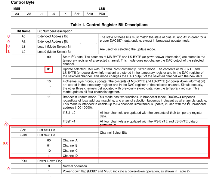

You select the DAC channel by setting bit 2 and 1 in the control byte (tx_buffer[0]). There's a helper function that gives a correct control record.
// address 7 - 6: 0, load mode 5 - 4: 01 direct from i2c, 3: reserved 0, 2 - 1: channel select, 0: pwr down 0
#define DAC857X_CFG_H0 0b00010000
#define DAC857X_CFG_H1 0b00010010
#define DAC857X_CFG_H2 0b00010100
#define DAC857X_CFG_H3 0b00010110
static const uint8_t array_DAC857X_CFG_H[4] = {DAC857X_CFG_H0, DAC857X_CFG_H1, DAC857X_CFG_H2, DAC857X_CFG_H3};
 * get the hex address for the requested DAC module
uint8_t getAddressFromModule(uint8_t module) {
    return array_DAC857X_CFG_H[module];
Bits 7 - 3 and 0 are all fixed.

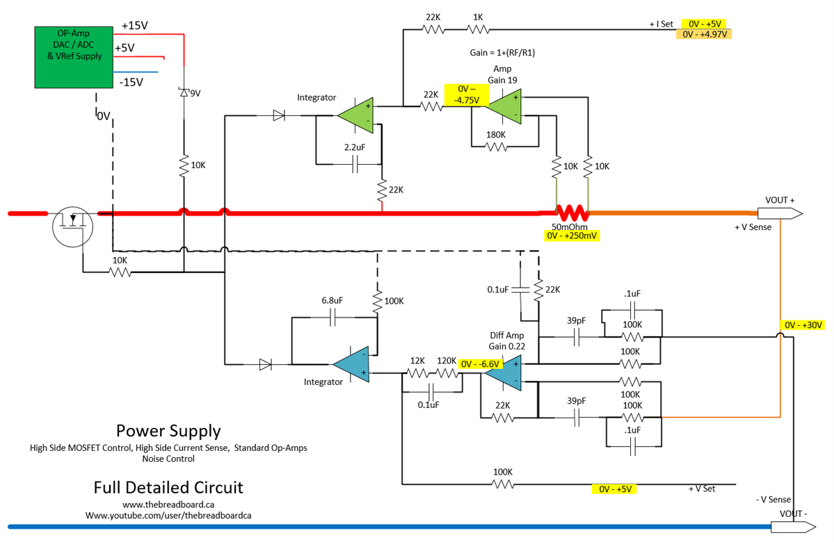

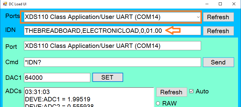

Remote Software
Teminal
Serial communication to the USB UART port.
9600/8/1/None
SCPI is a non-echoing protocol. To make the characters you type show in the Terminal, set Local echo to Force on.
If you also set Local line editing to Force on, you have the opportunity to correct characters in the current line before they are sent to the serial port.
Test:
*IDN?;SYST:ERR:COUN?
Should return
THEBREADBOARD,ELECTRONICLOAD,0,01.00;0
Windows GUI
There are two image. A .NET made by Peter, a Java version made by Jan.
The .net GUI supports reading the 4 ADCs, setting one of the DACs abd shoot any SCPI command.
There's a window for SCPI output and a status window that shows SCPI errors.
Source and binary available from https://github.com/thebreadboard/SCPI_DC_LOAD_WIN
The Java GUI is made as a POC that cross-platform instrument GUIs are possible.
It allows for switching the load on and off, set constant current and replicate the LCD values.
Additionally, you can requesst error status and run arbitrary SCPI commands.

    It would help if you could try to replicate these steps with your newer one:
    In CCS, select View -> Resource Explorer
    Install latest SimpleLink for MSP, if not done yet
    Then, from the tree view in that same Resource Explorer, load the following project into CCS:
    This will give you a new project called uartecho_MSP_EXP432xxxxx_tirtos_ccs
    Select it, then with the LaunchPad plugged in, press the debug button.
    When the debugger is loaded, open a terminal (PuTTY or whatever you like, 115200, 8 1 N , the com port is the one that represents itself as Application / User UART )
    Then press the resume button in CCS.
    If the terminal shows "Echoing characters:" the issue is with my hardware.
    If it shows "E" , then it may be an issue with the latest RTOS.

    It is possible that it hangs on the I2C ADC task if you don't have the PCB with DAC and ADC mounted. In that case comment out the I2C code in the adc_impl.c file, or remove the ADC and DAC tasks from the RTOS configurator..
    Peter has made a GUI to test the board. It also works with LabVIEW or a terminal program using the SCPI commands from the main post.

    Jan Cumps over 9 years ago in reply to jc2048
    I've just tested the 1_2 version of the ADC/DAC BoosterPack.
    The 4 ADC channels and VREF work fine.
    I can't test the DAC yet because I still don't have one.
    edit: ordered one DAC8574IPW
