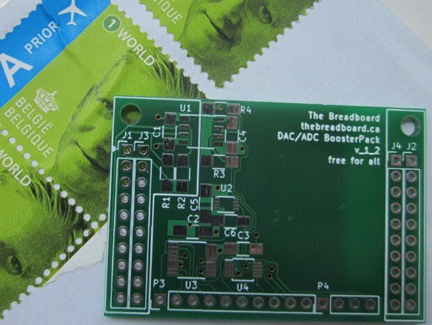

DAC-ADC BoosterPack
This module is a generic, isolated DAC / ADC boosterpack. It's the interface between the analog controller and the microcontroller.
It can also be used outside this project, for your other analog - digital conversion needs.
The board design is broken out in a separate post: Programmable Electronic Load - DAC / ADC BoosterPack.

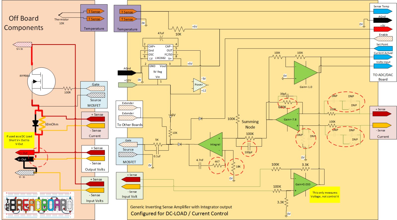

Analog Controller and Driver Board
This is the core of the analog constant current block. Here lives the circuit that will translate desired constant current into the driver signal for the power MOSFET.
It integrates the feedback coming from that power board. This is a closed analog control loop.
There are also components to provide the on-off functionality and buffers/amplifiers for the analog data-points that fly back to the ADC module.
The board, schematics and BOM are documented in Programmable Electronic Load - Analog Controller and Driver Board.

    Forgot to also mention - re the summing junction. This is exactly the same as connecting the feedback 100K to the output of the op-amp (Making it a stand alone gain without the rest of the loop) and is how an inverting configured op-amp works, we have simply extended the feedback to include the sense resistor and the mosfet.
  • Robert Peter Oakes
    Robert Peter Oakes over 8 years ago in reply to jc2048
    Nice work there Jon
    A Lot of the solution I think would be in selecting the right Op-Amp, one with hi impedance inputs for instance.
    One of the reasons for selecting such high value resistors was to significantly reduce the chance of frying the electronics if something went wrong with the power stage, I have already fried the entire project with my old design because the common mode volts went way out of range (Up to the source voltage of 30V), the resultant current I think exceeded the input diode protection (10mA) and the rest was history image. So 100K with even 60-100V source to the load leads to a max of only 1mA flowing into the protection diodes, well within its safe current.
    So could we reduce the values. Yes of course but I would be tempted to stay well away from the 10mA max current in a failure mode (Or a simple spike getting through), so perhaps not less than about 20K = 5mA in fault condition.
    Hope this helps to understand my choices.
    Oh, the summing junction is just a very simple way of balancing setpoint with measured and if you make both resistors the same with the same characteristics then there always going to be the same sum even if they get hot etc. They should drift the same image. Also if it's good enough for Agilent, its good enough for me image and it keeps the component count small, especially for the silicon.

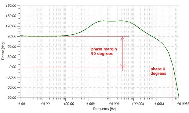

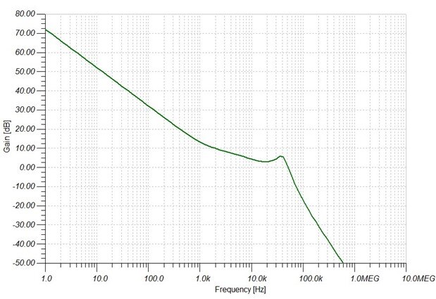

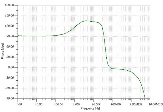

    Next I'm going to have a quick look at the stability of the original circuit.
    Remembering back to the things I learnt many years ago [I wasn't a very diligent student and didn't pay as much attention as I should have done], the
    necessary conditions for sustained oscillation in a circuit are that there should be feedback and, at some frequency,
    there should be gain of more than one (otherwise any oscillation will just die away) AND the signal fed back should
    reinforce and not counter the oscillation. Stability is more than just the absence of oscillation of course, but it's
    a good starting point and the tools that we use to look at it will give us some idea of how the circuit will behave
    generally (whether it will overshoot and ring if hit by a fast edge for instance). All of this was investigated by
    people back in the 1940s, the two most well known being Nyquist and Bode. Bode's method, derived from that of
    Nyquist, used separate gain and phase plots and was also useful where systems were measured (rather than the curves
    being pieced together from knowledge of how the individual circuit elements would behave theoretically). I'm going to
    try and see if I can get some Bode plots for this circuit using the simulator and then look at the effect that having
    some inductance in the test leads, used to connect the load to the circuit under test, might have. I haven't got a
    clue how you SHOULD do this [I was never taught anything about simulation], but other people do it so it can't be too
    difficult. [Just don't assume I know what I'm doing, that's all.]

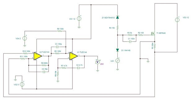

    Here's the circuit I'm using:
    What I'm doing is simply breaking the loop, feeding a signal in from a signal generator and recording the signal that
    finds its way all around the loop and back to the break point. I'm measuring the open-loop response rather than the
    closed-loop response. I've set the normal circuit input to a fixed value of 2V. By the way, that break in the loop
    can occur anywhere around the loop. That seems a bit odd at first but, if you think about it, wherever it is that you
    break the loop, one complete circuit round has to have the same effect. The break must be in the actual loop, though,
    whether it's in the forward path or the fed back path.
    There's a complication with this circuit, though. The feedback sets the operating point for the MOSFET. With the loop
    broken, it won't find the correct operating point and I'll probably just be sending a small signal round the loop
    through the gate-source capacitance and the results will be wrong because I'll be measuring something different to
    what the real circuit does. So, what I did was to get the simulator to analyse the dc nodal voltages with the loop
    intact, read the voltage at the end of the diode where I'm going to attach the signal generator, and then I added
    that voltage as a dc offset to the signal generator so that the small sinewave it uses to do the frequency analysis
    was swinging around that operating point. [I imagine that there's some clever way to get the simulator to do that for
    itself, if only I knew what it was - I couldn't think of anything that wouldn't upset the results.]
    Here are the plots of gain and phase for the circuit with no added inductance on the output.
    We can derive two figures from these plots that give us some measure of how far we are from oscillation. The phase
    margin is how close the phase gets to zero degrees (or +-360, depending how the simulator likes to give it to us on
    the plot) before the gain gets down to unity (0dB). The gain margin is how far the gain is below 0dB when the phase
    gets to zero degrees. People sometimes define the phase margin as being the value when we get to unity gain. I think
    that comes from considering the simpler situation of amplifiers where the gain and phase will often both decline
    nicely at higher frequencies and the worst case for the phase is then the same point as the gain falling to unity.
    With something like this, where the output load has a major effect on how the loop performs (the output load isn't
    inside the loop, but the current through it also flows through the current sense resistor which is), we're rapidly
    moving away from a simple textbook example.
    I've drawn these onto the plots with a paint package. The phase margin is 90 degrees and the gain margin is 34dB.
    They are both very safe. People seem to have different ideas about what constitutes an adequate gain and phase
    margin. Integrated Electronics (Millman and Halkias, 1972) says 'a linear amplifier of good stability requires gain
    and phase margins of at least 10dB and 50 degrees respectively'. Other books I've read suggest 30 degrees is
    sufficient for control systems. The complication is that we are just looking here at one aspect of how the control
    loop behaves and there are other criteria to look at too. For instance, we may want to trade some stability for
    better agility and a faster response (one immediate observation we can make of the gain plot is that the loop runs
    out of gain at 23kHz - that means there's no possibility of oscillation further up, but the load isn't going to be
    doing very much either).

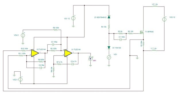

    Here is the same test again, but this time with two test leads each having 1.4uH of inductance. (That's one metre of
    1.6mm [14 AWG] diameter wire with no coupling between the leads - in practice there would be some mutual coupling
    where the leads come together at the load and at the circuit being tested, even if you spaced them as far apart as
    possible in between.)
    This time the phase margin is just 23 degrees and the gain margin is 13dB. Although it's still stable [in the sense
    of not oscillating], the much lower phase margin means that it may overshoot and ring on a fast edge. [What would be
    interesting here would be for me to try a range of different inductances to get a feel for how the two plots vary.
    I'll have a go at that over the weekend if I've got time.]
    Remember that this is the result of a simulator running, so it's only as good as the models and I wouldn't expect it
    to be totally accurate, particularly as the frequency goes up and parasitic capacitances come into play. In any case
    the models will be using typical figures (or perhaps worst case 25C figures for the leakages and bias currents?) so
    there will be more variation there. Also, I substituted an alternative part for the MOSFET that Peter originally had
    and the internal capacitances between the terminals will be different. So this is all a bit rough and ready - it
    helps us understand and is a guide to what the circuit would do but it isn't reality. The other point to remember is
    that this is the small-signal performance - things will be different for large signals where op-amp slew rate comes
    into play and there is also the possibility that signals will distort.
    Edited 12th June 2017: I pasted in the wrong circuit and curves for the case with lead inductance (I had the 1mH ones,
    and they should have been the 1.4uH ones) - I've just replaced them.

    Bribe has arrived. Thank you Jan.
    Jan Cumps over 8 years ago in reply to jc2048
    correction: 2 adc/dac pcbs image

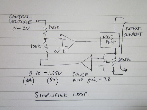

    I'm back again, after a bit of shameless bribery from Jan (I get one of his spare ADC/DAC booster boards in return for some more thoughts and comments).
    I'm interested in how the control loop works: why there's such a large offset at the bottom end of the current range (and what can be done about it) and what the advantages are (if any) of the summing arrangement (which I'm not familiar with at all).
    I don't have much of a background in analogue design, so I'm learning this as I go along. (Please shout if you see me getting things wrong.)
    Input Bias
    Here's the control loop in a simplified form so that it's easier to see the control action. (I've stripped away all the frequency dependent stuff, so we're looking at dc here - keep in mind that there will be other complications at ac.)
    Here's how I see the control operating. The control input is a positive voltage in proportion to the desired current. The signal fed back by the current sense amplifier is a negative voltage (it's negative because the gain is -7.8, not 7.8). The op amp acts to try and make both of its inputs the same voltage, so with the two resistors the same value, the fed back voltage will match the control voltage, except for its sign. If the control were set to 1.95V, the opamp would control the MOSFET to give 5A through the sense resistor so that the fed back voltage were -1.95V and the voltage at the + input to the opamp was then 0V.
    Now, what is the current through the pair of resistors for different input voltages? Let's pretend for a moment that the opamp is perfect and doesn't load the midpoint at all.
    Input voltage    % of full scale    Desired Current    Resistor Current
    1.95                 100                      5A                       19.5uA
    195mV             10                       500mA                1.95uA
    19.5mV             1                       50mA                   195nA
    1.95mV             0.1                    5mA                     19.5nA

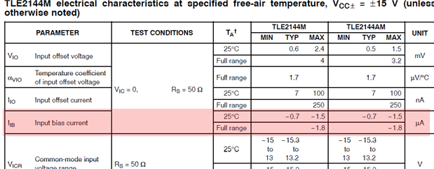

    That seems fine (perhaps 'fine' isn't the word - it seems to me to be a fundamental flaw of the arrangement the way the control current falls off for low control voltages - maybe a doubtful 'plausible' or 'possible' might be better) until we look at the datasheet for the opamp and see this

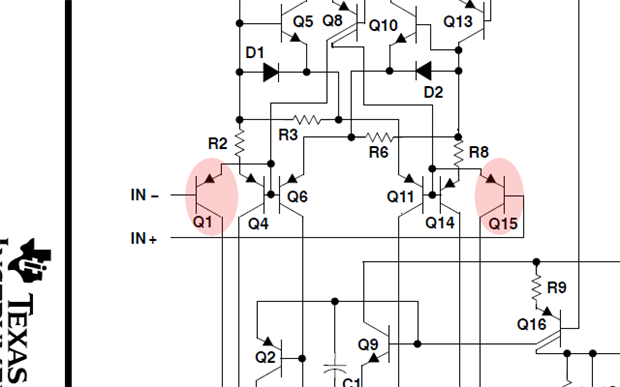

    In case it's not clear why the current is negative (flowing out of the chip), here's the equivalent schematic from the datasheet where we can see that the input transistors are PNP
    The Input Bias Current that flows out of the bases of the transistors is typically -0.7uA [for supplies of +-15V]. If we compare that to the current through the two resistors, we can immediately see that there is going to be a problem at the lower end of the input control voltage range where the bias current is much higher than the current through the resistors.
    Can the circuit be improved? My first thoughts on that would include the following.
    One option would be to decrease the size of the resistors. If we made them 10k, rather than 100k, the resistor currents would be ten times higher. That would help a bit. How far could we go with that? It looks like the current sense amplifier can drive 1k or 2k sensibly. I don't know about the DAC.
    Another thing we could do is to be very rigorous about balancing the inputs to the opamps. Whilst the bias current is fairly high, both inputs will match well [the transistors will be almost identical being fabbed on the same piece of silicon] and the currents tend to cancel if we can make the resistance looking out of the terminal the same for both the input pins. A problem there, though, is the frequency selective network feeding back locally around the opamp - what frequency do we make the inputs balance for? It has to be DC, but then it's going to change as the frequency goes up.
    A more obvious option would be to substitute an op-amp with a lower input bias current. There are bipolar op-amps with much lower bias currents (they include extra circuitry to offset the current internally), MOSFET-input op-amps have an input bias current in the pA area [mostly the protection diode leakage], and FET inputs are almost as good. However it's complicated by temperature [leakage currents climb quickly with increased temperature], so substituting an op-amp is a bit more complicated than just choosing on the basis of one parameter (and we may just be swapping one problem for another).
    There's also the question of whether it's good to stick with the summing junction approach.
    Before considering that any further, I'm going to see if I can look at the stability and the frequency response of the current circuit - partly to find out how to do it, partly to understand what bearing the summing arrangement has on the stability, and also because I want to see what effect output loads have and what a reasonable spec might be for such an instrument.
    Robert Peter Oakes over 9 years ago in reply to jc2048
    The gain is selected in part to use absolute standard resistors, no trim pots etc, and 7.8 was close enough to the max Ref voltage to be suitable and leave a little room for detecting over voltage, use for AutoRange via the PGA or other possibilities. Remember the Vref is only 2.048.

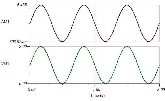

    This is now the output for a 1Hz sinewave with the circuit and values you show above. [But not the actual MOSFET - I found a model for the IRFP064, but it won't import into the simulator properly. Shouldn't make much difference at dc, though it might affect the frequency response further up. And I've got no idea how good or bad the model for the TLE2144 might be.] Red trace is output current, green is the control voltage.
    These are the static dc readings input/output
    2V   5.434907A
    1V   2.869393A
    0V   0.303897A
    The gain is slightly wrong and there's an offset of about 300mA.
    The differential amplifier gain needs to be -8 rather than -7.8, doesn't it? 5A through 50 mOhm is 0.25V, so gain is -2/0.25 = -8.

    The idea is that the two differential op-amps are used to scale the sensed inputs and also level shift them into a usable range for the op-amps. the output of these is fed into a summing junction (2 resistors). the Setpoint range is 0-2V based on a 2.048VRef, this is for the Voltage sensing / Setpoint and the current SP. and should represent a 0-10A, 0-60V range. I just noticed I have the wrong current sense resistor, it is supposed to be 25mOhms for the 10A version and 50mOhms for the 5A version so as it stands it would be 60V and 5A,
    The two integrators are intended to correct for small offsets between set point and measured setpoint, the closer the two are, the slower the integrator will drift from nominal., this should also prevent wild oscillations etc, basically a partial PID control.
    The board I will end up with for the voltge control and the current control will be identical, the only difference will be a few capacitors and resistors not being populated or simply changes in values to change the gain,
    The Zener feeding the FET is to limit the max voltage being applied to the gate, the FET without the control being applied is forced on and the control circuits pull it off, this makes it easy to have both Voltage and Current control
    One thing you have on your diagrams int eh simulation is the supplies are off. The OP Amps and Zener are fed from a separate 12V supply of which the GND floats on the source of the FET (The junction between the FET and the sense resistor)
    I am not sure if this would affect your simulation but it may.
